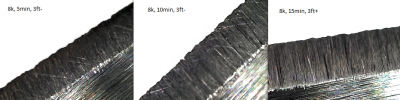

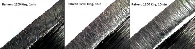

Ok, I decided to give it another go on manual sharpening this material. After the first session, I think I did not change my technique enough and was likely applying too much pressure in general. So today's plan was to do a 16k (1um) stropping on how I left the Rahven, and check under the scope, just to see what it might look like. Then start low again and work my way up from 1200-4000-8000, then re-strop on the microfiber block loaded w/16k.
Spoiler alert - I got set-back at each grit change, essentially back to baseline. So, somewhat rookie mistake here, but my 4k and 8k diamond plates were new, and they cut far too aggressively before being broken in, despite the super light pressure used. I did, however, get some positive feedback on the 3-finger test (indicated in each pic either + or -), which, unfortunately didn't necessarily translate into smoother cuts on paper tests. The knife was always able to push-cut paper, just varied in smoothness.
First, the 1200 worn stone probably had the best overall results. It will be interesting to see how the other plates do once they wear in.
Round1 - 1200k (well worn from previous session):

Round 3 - 8k (new):
So initially the stropping seemed to decrease the sharpness, maybe due to the give of the microfiber, allowing it to curl over a bit on the apex, the pics seem to indicate this.

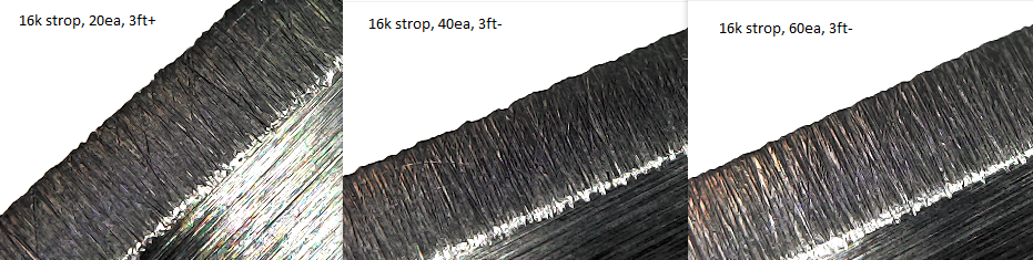

Round 4 - 16k stropping (new block and media):
I went much lighter and decreased my angle a bit, and I got it back up to 3ft+ grippy.
Round 4-2 16k stropping to 3ft+, +bonus pic:
I am starting to think a very high grit, somewhat worn diamond abrasive may be the way to go, start to finish. By hand it will take a very long time, so might need to try some belts in the shop.

Interesting - I only tried stropping on the stones given the previous advice. So, I spent an hour or so working the material on some waterstones. First, I tried 1200, and it does actually cut, but the edge becomes very chippy. Then I tried the 4k, and it started to polish reasonably well. Still pretty chippy though.
Then I thought - if the edge is so thin and brittle, we should NOT have slurry on the stones. So I left a very light stream of water on the stone as I worked on the 4k, and the results are promising, albeit slow. I am polishing out the previous grit scratches, and the cuts are getting smoother. Following the same line of thought, I can feel tiny chips/grit on the stone develop if my angle gets a bit too high or I get too close to an edge on a stroke, and they are very tiny pieces of the HIC. My hypothesis: When you go over a tiny HIC chip while sharpening, it creates new chips on the apex, leading to perpetual chipping...UNLESS, you keep the stone very clean during the process. This feels right to me.
Here is the 1200 progression:
