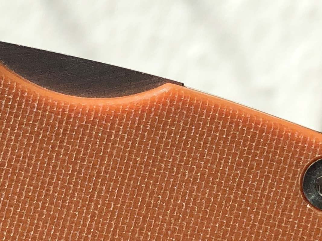

Just got my REX45 Native Chief.
Since this is my first Spyderco backlock... is it normal for the spring to perceptibly protrude over the backspacer when the knife is open? They're perfectly flush when it's closed.
I'd say 25% of my Spyderco lockbacks have lock bars that don't seat flush. One of my Rex Chiefs is perfect there, the other is off enough I considered returning it.
I'm usually not too picky about blade centering and other more cosmetic flaws, but I'm not a big fan of how the lock release feels during operation when they're real off.
That sure sounds like a lot. Not sure how I feel about this yet.

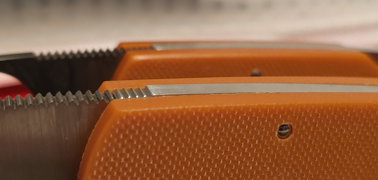

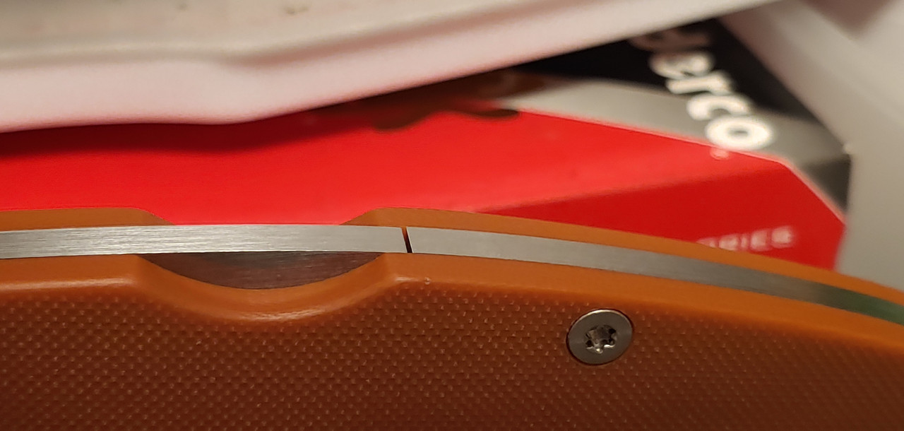

Here is a comparison with my user and the unused back-up.
On mine it's the other way around.
This baffles me. It's what I consider the exact opposite of "tight" tolerances.
I keep getting this from Spyderco... basically every single knife I bought had flaws like this. I'm not exaggerating, it's been every single one. Because I like the designs I force myself into condoning the obvious, but once again I'm just baffled.

I wonder if the lock will seat deeper into the blade tang as it wears in? I would check that lock bar and lock well in the blade tang for burrs.

Looks bad. I would definitely try to defeat the thread locker (heat) and take them apart to clean them, there might be something stuck in there causing this.
