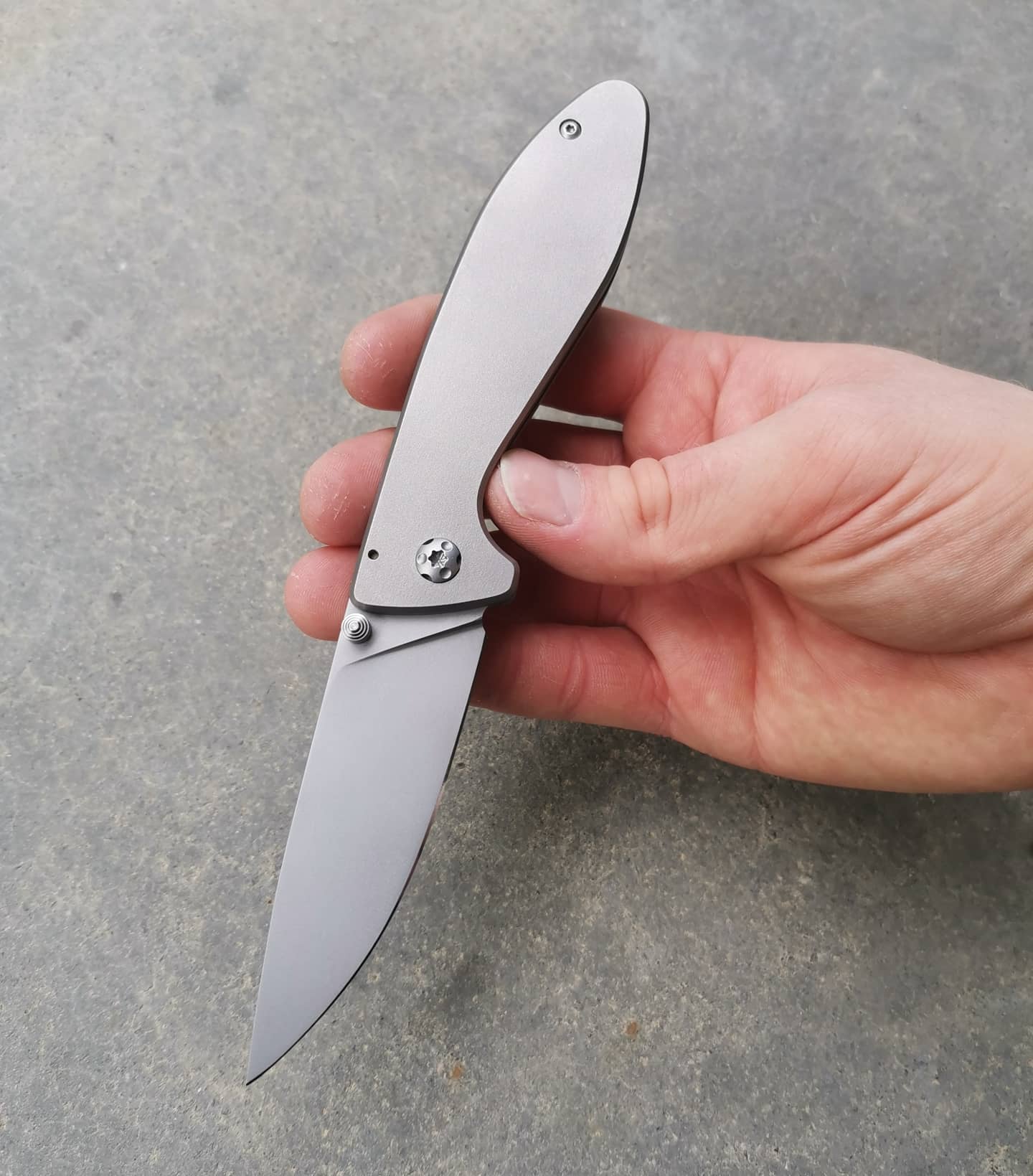

I/we have already made a prototype elastic ceramic folder blade, for my "Turbo" framelock model. This is one with steel blade: https://www.instagram.com/p/CP5Q6OCD-FX ... =copy_link
But when I tried to do it with the elastic HIC ceramic, there were some things that weren't working like I wanted them to. Because with 2mm stock, which is what we currently produce to serve the chef knife demand, it is not ideal. So 4mm stock is the way to go, unless we are talking slip joints. But I want a locking folder, therefore 4mm stock it has to be.
The target weight is 40-60 grams total-I think that is realistic. "Ghost" is a great name btw!! Titanium screws are no biggie, probably the right ones are even available at some retailer. And even if not, they can be sourced with little to no trouble. Now, all the excitement aside, lets see first what Spyderco/Alex has in mind after the weekend.

I like the idea of 4mm stock to add rigidity and strength for a folder. A hollow grind could keep up the slicey nature of the folder while beefing up the knife to 4mm. I don’t have IG so I could not see the link.
Someone please chime in with the proper screw size needed for the mule and I will look up to see if titanium screws can be found.

Hollow is an interesting idea! Some pictures are here on my website too: https://www.kase-knives.com/start/models/
