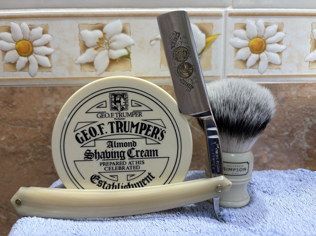

Here's some more eye candy while we are waiting.
See on the blade just before the tang there is a step? That area is a rear stabilizer. The blades are so thin that often there are one or two stabilizers to keep them stiff. Some razors, like my Colling, have a horizontal stabilizer (aka belly) on the blade just above the edge to keep the blade from flexing all over the place.
Razor: Thiers Issard with C135 steel run at 65 HRC. Blond horn scales.
Soap: George F. Trumper Almond
Brush: Simpson Chubby 1 in Sovereign Fibre
Shave: Perfect. Near BBS (baby butt smooth), no irritation, no bumps, no cuts, no weepers
