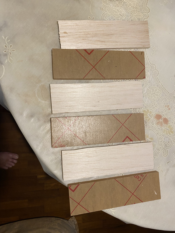

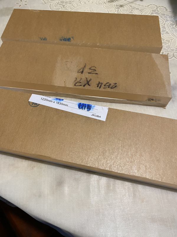

I finally got my acrylic bases cut to size (12"x3"x .59" or 76.2mm W x 254mm L x 15mm) and I received my balsa wood plank 39" long x .39" thick. I also got some 400 grit sand paper. The next step is to cut the balsa to fit the acrylic bases and glue them together.
Doc Dan
Posts: 16313
Re: Straight Razor from Spyderco
#446
Post by Doc Dan »
I cut the balsa wood to the same length and width as the acrylic bases, which I got cut also. I haven't peeled the protective paper off of the acrylic. I will do that when I get ready to glue them. It was a busy day and I didn't have time to glue anything, only cut the wood to size. Tomorrow I will glue the balsa to the bases. After that, I will sand the wood to make sure it is flat.
