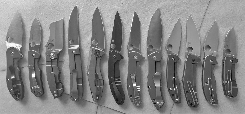

Sorry, I missed that part. I have a handful of titanium frame locks including the Paysan. My Spydiechef was purchased at the Spyderco Outlet store about a year ago, so it’s one of the newer ones. If Spyderco is willing to repair, replace or refund, that’s pretty good. Sadly, negative posts will outnumber positive posts from customers, so it may seem overstated the unhappy vs the happy customers. Decades of a successful knife company must mean something right is going on there in Golden.Perhaps_OCD? wrote: ↑Thu Mar 09, 2023 7:32 pmDid you miss the part where I did send it in for warranty, waited 3.5 years, and got a defective knife back? Spyderco's "amazing warranty" is to sell all of the sprints or high demand knives they make, and not hold any back for exchanges. They've told me this themselves. Note: good vendors make up for their negligence by keeping their own reserves.Fireman wrote: ↑Thu Mar 09, 2023 5:37 pmI love my Spydiechef and use it almost daily. I have had zero issues with mine but if you are not satisfied, Spyderco has an amazing return policy and they stand behind their products. I would send mine in for a replacement or repair before I complain on a public forum. Sorry you had issues, Did you send your problem knife in?Perhaps_OCD? wrote: ↑Thu Mar 09, 2023 4:59 pmAll of the knives work. However, I don't for a second think the majority of us knife nerds are looking for something that "just works". Its why we aren't carrying a Kershaw from the local Walmart. (not picking on you, just responding to the 'its a tool' crowed that pretends sprint runs are for batoning wood / denys these are items people buy because they're nice)
None of the Spyderco frame locks I've had have been without lock stick or lock rock. I have had probably 30 ZT's, 10 or so Kizers, and 5 WE's for comparison. Not a single one of those brands have had lock stick or lock rock. Some have had detent issues, but that's the thing. On those knives I could bend the lock bar left and right to my hearts content (increase or decrease the tang contact and detent pressure) and no matter what I did to that lock bar, it engaged properly on the tang without stick or rock.
That's because those companies have figured out how to eliminate back and forth lock bar play and (most importantly) get the geometry of the contact surfaces right. It's an R&D / engineering problem Spyderco simply hasn't mastered. Without getting too technical, it's kind of visible in the amateurish nature of the Paysan & Spydie chef's lock bar design. A long and thin little sliver of a bar isn't exactly a recipe for ensuring the tip of that bar lands on the blade tang consistently and properly.
I'll definitely be sending this one in, but I don't expect them to be able to send back a proper replacement. I'll ask for $920 in store credit this time. MSRP to MSRP
Do you have a similar priced frame lock to compare the spydie chef to? Maybe my curse is having good frame locks to compare it with.

I have 14 models from Spyderco with the RIL. Of these, only the Spydiechef had slight lockstick when new. It has since smoothed out, and functions as it should.
All of these knives get used, even the more expensive ones, and none of them have exhibited lock rock.

I only have two RILs, the Spydiechef and the Brouwer, but they have both had a lot of use and function perfectly. It's not my favourite lock type but I can't see how these two could be better. Not dismissing the OP's concerns but I don't think you can say ALL Spyderco framelocks are poorly executed.
