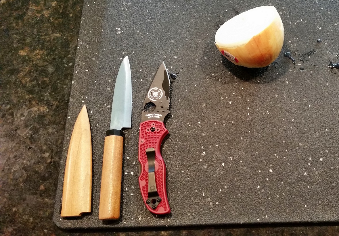

I'd like to know how well it holds its edge compared to H-1... I think Lance has probably written about this before, but a comparison with a mule size blade would be interesting. I just lucked onto a good deal on a Never Summer LC200N Native 5, but unfortunately (?) it's in mint condition and I may not be able to bring myself to use it for a while.
