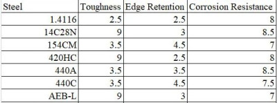

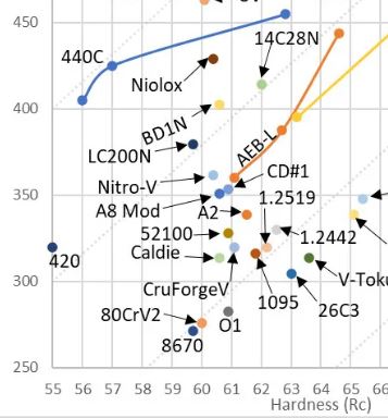

awa54
Posts: 2736
Location: Vermont, USA
Re: High Performance Delica Excitement
#378
Post by awa54 »
Doc Dan wrote:
Fri Jul 19, 2024 9:11 am
I haven't heard that, but it could be. 14C28N is supposed to be AEB-L improved. Same toughness, better edge retention and corrosion resistance.
looks like at the same hardness (RC 62) 14C28N is better on paper.
Kershaw 14C28N (USA) and Civivi (China) both have easier to deform (and grind) edges compared to my AEB-L Spyderco Urban (Italy).
My strong suspicion is that the Urban is at several points RC higher than the other two knives...
I'm also not really sure what Nitro-V is supposed to bring to the game, since it doesn't outperform either 14C28N or AEB-L on paper, or in my use (Civivi) ...unless it's a lot cheaper to produce?
hardness edgeret.JPG (30.37 KiB) Viewed 2303 times
-David
Doc Dan
Posts: 16260
#379
Post by Doc Dan »
awa54 wrote:
Fri Jul 19, 2024 7:27 pm
I agree with you on the Nitro-V. I just don't get it. As for the 14C28N, a lot of us on this forum love the stuff. I have a couple of knives in that steel that were run pretty hard and the edges last a good while at razor sharpness. When it goes away, it goes away, no middle ground. Like AEB-L/13C26 it is really easy to sharpen for me, though, so touch ups are a snap. On Larrin's chart it has 440C having better edge retention, but that has not been my experience, at all. I would reverse those numbers, well, maybe 440C is better than 3 a bit.
