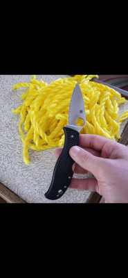

Here are the options I have available to put thru testing in terms of serrations. H1, 8cr, vg10, and k390. H1 is now H2, however if Sal wants me to test H1 I can most certainly do that. The police will need to be binder clipped to stand on equal footing with the others. In terms of the cold steel vs spyder edge im thinking double agent 2 vs persistence would be the best comparison, but thats down the road.

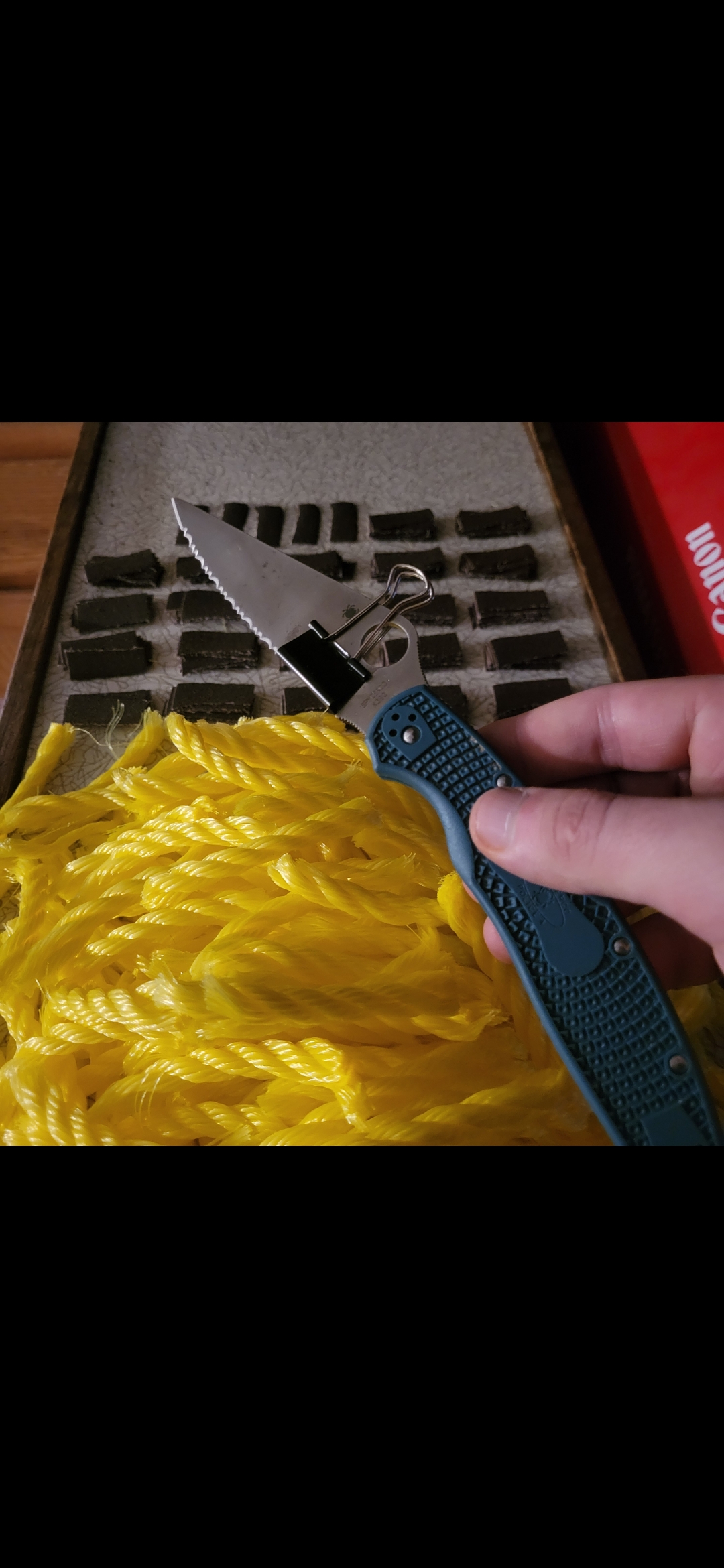

Im testing serrated k390 today. The model is a police 4 which reaches the next tier of my testing based on cutting edge length. To create an even playing field, I attached a medium binder clip to reduce edge length. Comparison picture against the leaf jumper. So far im 100 units of work completed, and the edge is perfectly fine. This knife is only sharpened on my 800 grit king neo which is harder than ceramic but not as hard as cbn/diamond.

Re: Steeltoez83 testing log
The serrated k390 has surpassed vg 10 in my testing. At 260 it is still passing with flying colors.

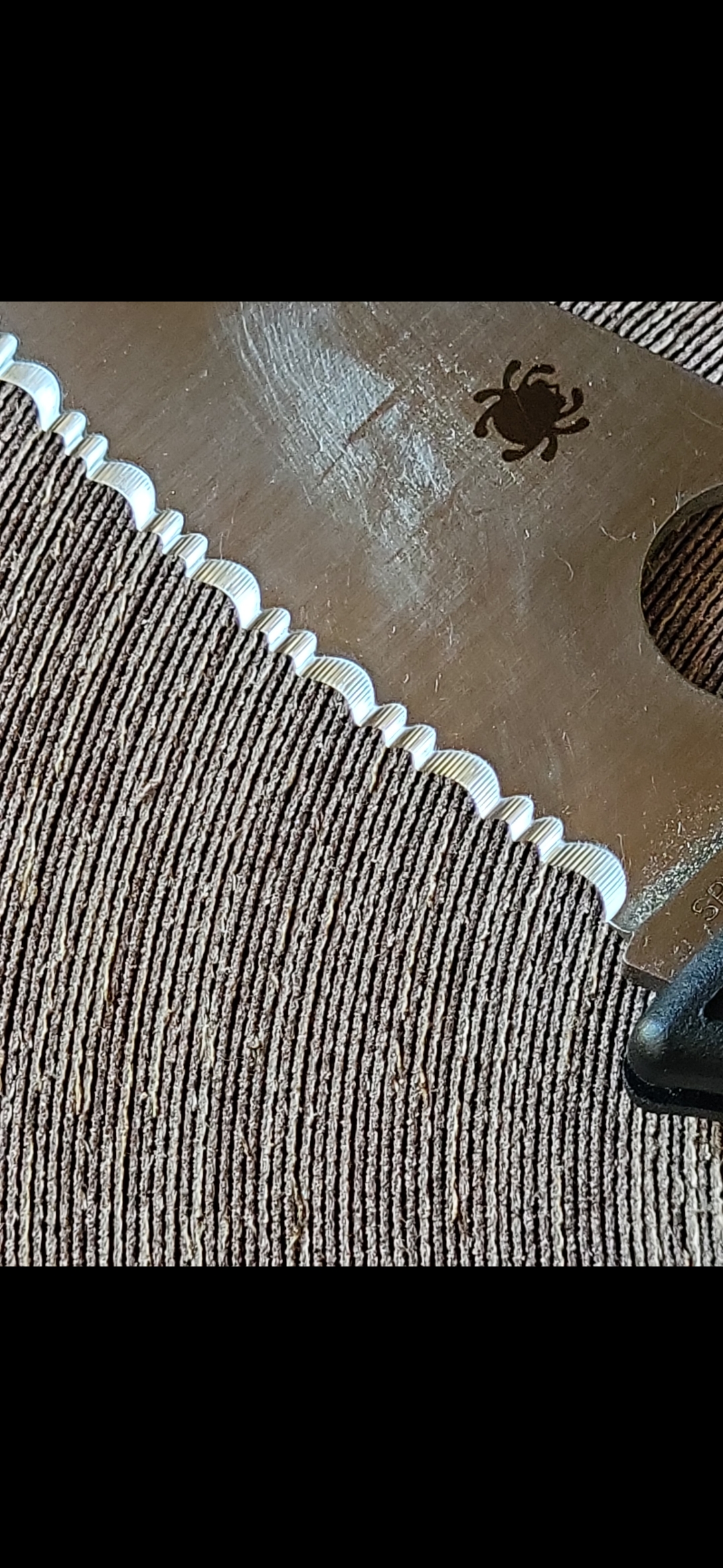

I did a quick sharpening video on my serrated LJ vg10 a few days ago. Im occupied with another project so it will be some time b4 this gets cut tested.
In terms of sharpening, I use a fine india 400 to start. I use 3 different angled strokes to make sure im getting within the scallops. Depending on how dull is where I start the waves at. In this case I was very dull so I started at 4. 4 sets of the 3 different angled strokes- 1 reverse stroke to remove any burr. Descending to 3 sets of 3 strokes- 1 reverse stroke- then 2 sets of 3 strokes etc. After im done with the india, I moved to the spyderco brown ceramic and did the same thing starting at 4 sets of 3 (12) and going to 1 set of 3. I prefer this combo because the brown spyderco stone is refining what the indy established.
I freehand mine, so thats right hand hold- push cutting the stone kinda sharpening on the corner of both stones for my progression.

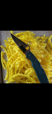

Im taking my time with testing this edge on the leafjumper. So far 180 units of work, and the vg10 is still passing. I forecast failure around 260/270.

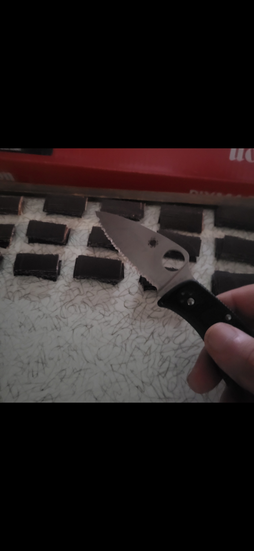

The final number is 300 for the LJ.
When I evaluated the edge, I used the area closer to the tip. As the heel area becomes gradually more blunt, the tip area has to assume more workload. I chose a test media I feel like highlights advantages for serrations. Technically my testing uses 2 media's, to represent the workload of an every day user. The k390 wasn't as deep as the LJ in terms of scallop depth, therefore it blunted closer to its plain edge counterparts. If the geometry matched evenly, It might have hit 650 maybe 700. Its speculation, however geometry in my testing has an effect on the blunting process. Im sure Sal figured this out decades ago.
It is of my opinion that I would need at a minimum another entirely different test to better evaluate serrations. Geometry, steel/heat treat, the media being cut, its all connected. Trial and error is part of the growing pain process.

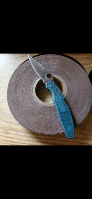

605 for the received edge on this shard from Roman Kase` (accent belongs over the e) from kknives_switzerland. My original order with Roman was for nitrobe 77, but my IG account got hacked. I asked him what steel he wanted me to try out, he responded s290. He also said there wasn't much data for it either. So far its a strong performer which was to be expected.

How are you sharpening the serrations with the India stone? Using the corners of the stone? Freehand?

Affirmative. I like the india fine (400) as a precursor to the medium (brown) benchstone. I feel like it delays swarf build up and reduces burnishing but thats just a theory of mine. I also do it freehand as well. I recorded a short video of the sharpening session for my youtube channel if your interested in a visual aid.
