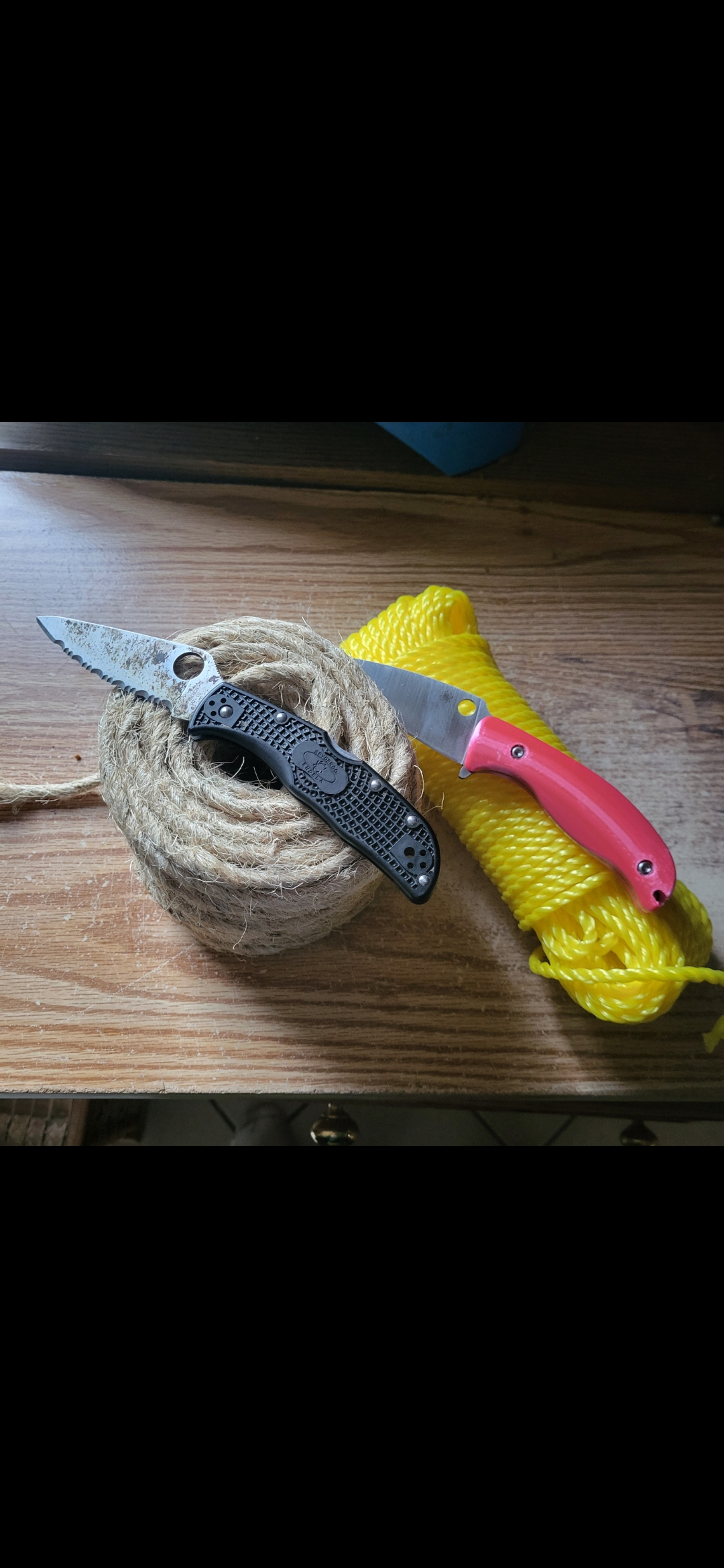

Im still dialing down specific criteria for the serration testing. Didn't make the progress I'd hope for today, but its a WIP- work in progress
Here's the difference between 1/4 and the 3/8 sized polypropylene rope im using now. Finalizing when the serrated platform becomes what I feel is dangerous to the user is still being explored.

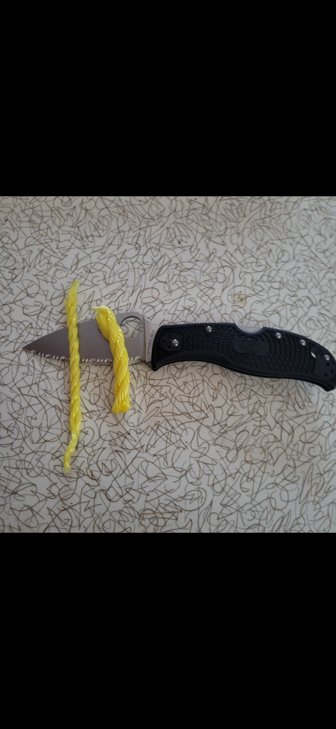

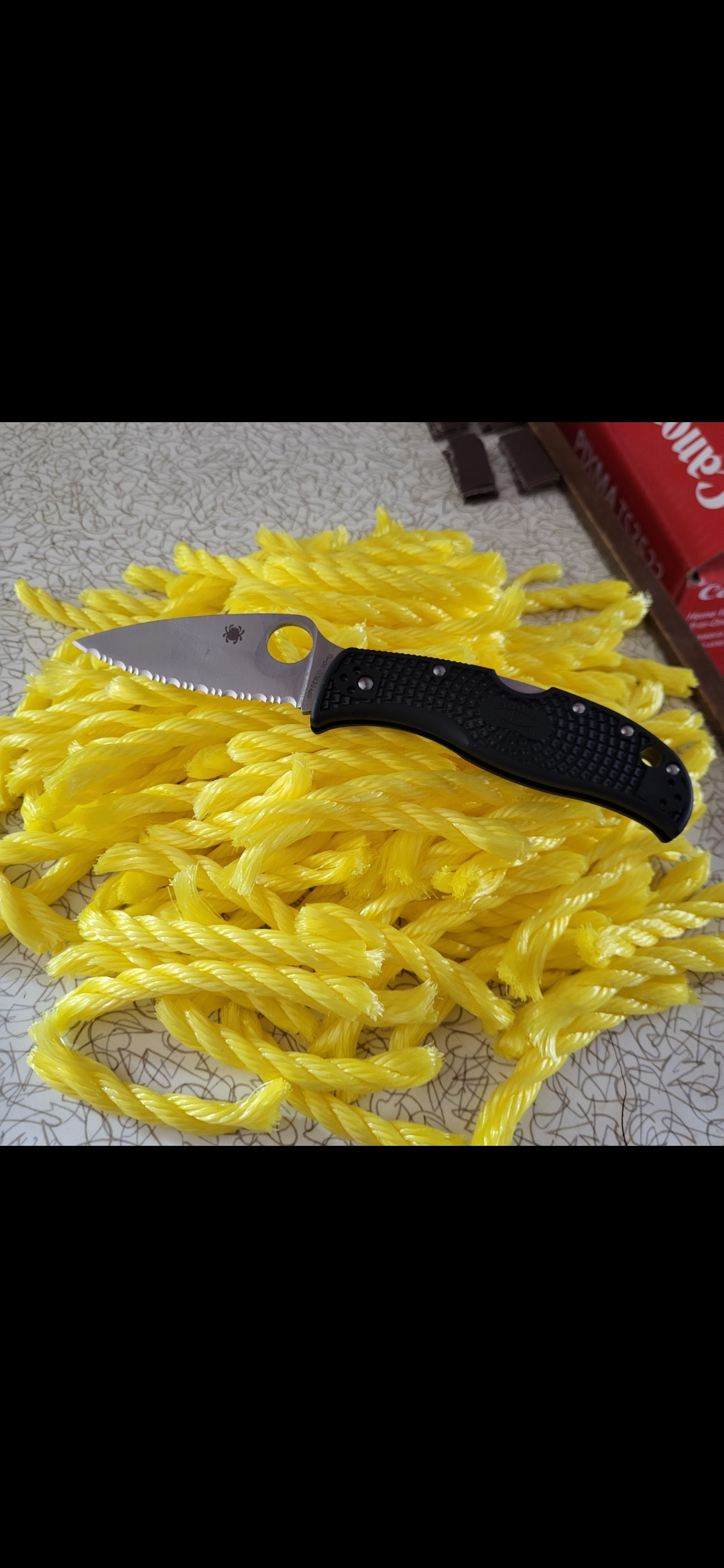

The serrated vg10 leaf jumper showcased a 30% increase in edge retention today reaching a score of 252.

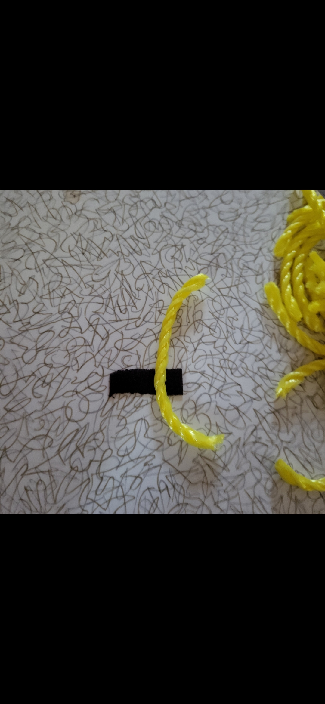

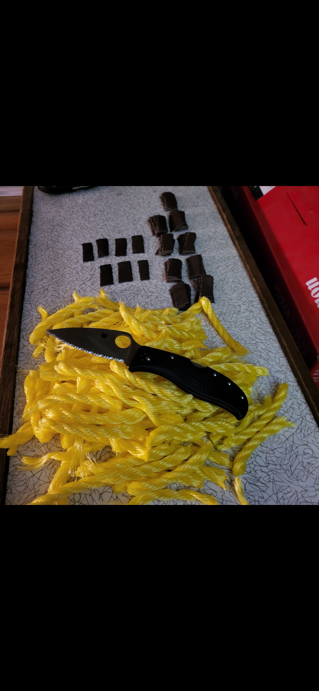

Some pictures from yesterday's testing.
