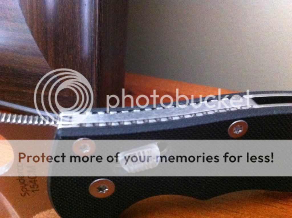

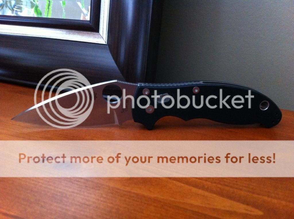

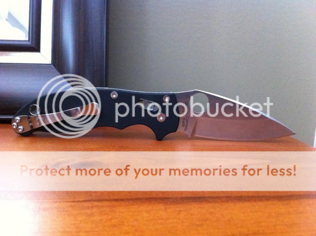

Well, thanks to Madrookie and Goldenspydie I modded my Manix 2. I swedged it, ground down the handle jimping, and skeletonized it. Got rid of .6# altogether. After the locktite cures, I'll see if it feels any lighter. That's what I dislike about it - it's a rock. What a pain, that lanyard hole tube is! Luckily I had something to peen or spread it with. I think this knife really needs another screw near the back. Anyway...

Jazz wrote:Well, thanks to Madrookie and Goldenspydie I modded my Manix 2. I swedged it, ground down the handle jimping, and skeletonized it. Got rid of .6# altogether. After the locktite cures, I'll see if it feels any lighter. That's what I dislike about it - it's a rock. What a pain, that lanyard hole tube is! Luckily I had something to peen or spread it with. I think this knife really needs another screw near the back. Anyway...
Know exactly what you are saying about the lanyard tube. Found that out the other day when installing custom scales on my Manix 2. It took me a while to be the original scales off without damaging the tube or the scales. I had to chamfer the inside edge of the holes for the tube (scale), work the scales until they started, and then press them on with my bench vise. I had two pieces of 9 ounce leather between the jaws of the vise and the scales. They are a press fit and there is no need for a extra screw.
By the way they are Allen Putnam scales in the honeycomb pattern in Toxic green. My daughter was watching me reassemble the knife and she said " hey dad those look like a turtle shell pattern". We named it the Ninja Turtle edition Manix 2!

v8r - After I reattached the tube, it was loose, so I had to respread/chamfer the tube. Not cool. For a tough knife, that's a weak point.
