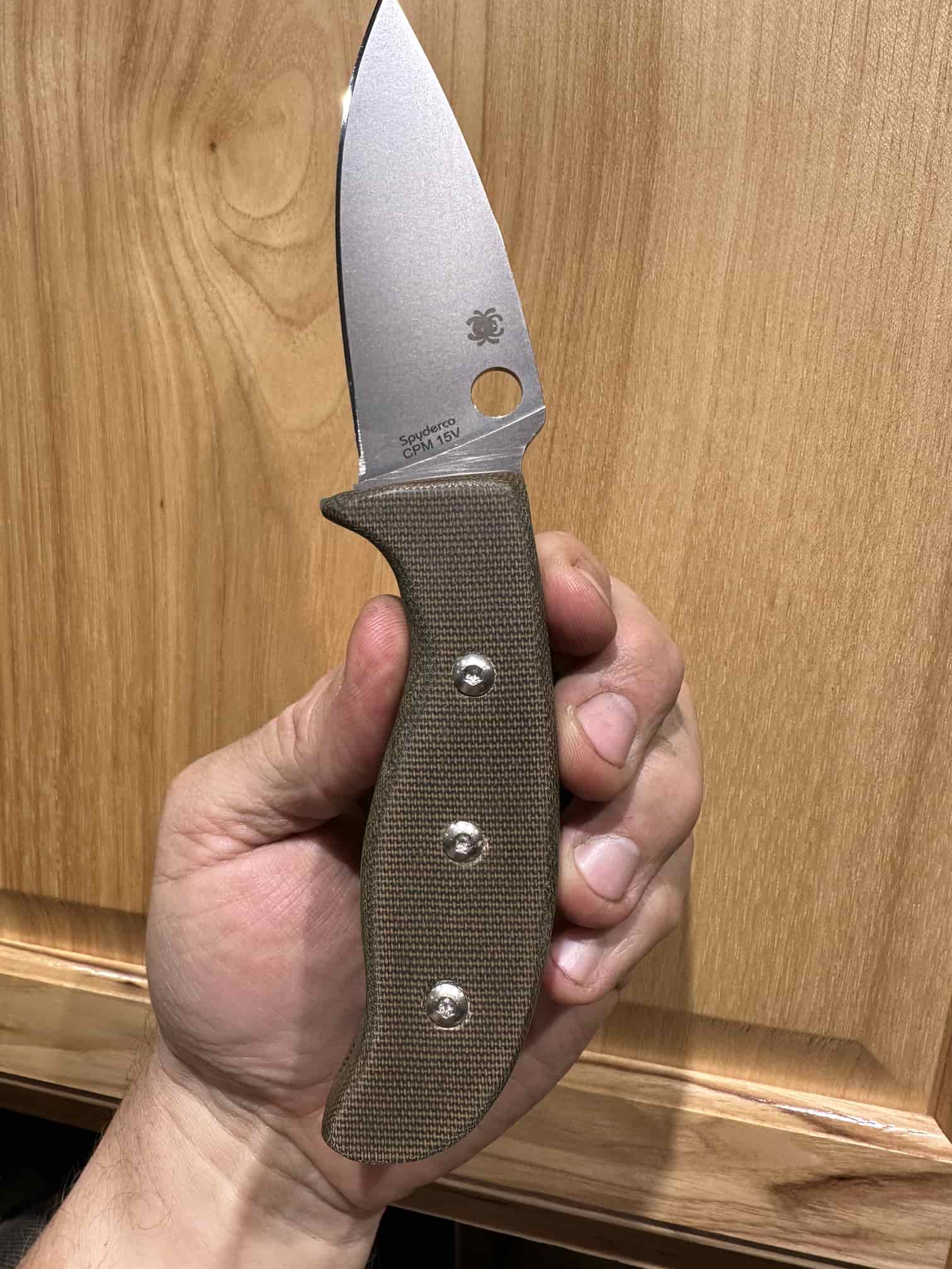

That edge near the ricasso looks like it's been sharpened too much!ykspydiefan wrote: ↑Fri Jun 02, 2023 8:31 pmDropped on my door. Hotter than a pan of cookies. I bought two, one accepts scales easy, the other will need some work.
