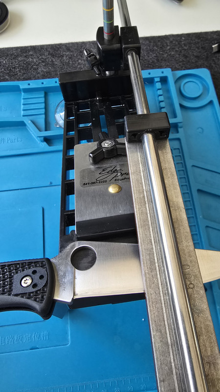

A lot of the replies here beg the question:
why did you settle on a sharpening system that can't sharpen the full edge?
I use rectangular diamond stones that have no issues hitting the full edge. They were only $10-40 a piece. I also have spyderco ceramic stones for finishing the apex that again hit the full edge without issue.
I'm not sure why folks would go with round stones or systems that can't hit the beginning of the edge well. I get using a round rod between full sharpenings for touch-ups, but not for setting edges.
A lot of sharpening systems seem to have serious drawbacks I never encounter with a simple bench stone.
I know a lot of them only go down to the 17-20 degree range too, which is absurdly thick for a pocket knife edge....for my uses at least. I keep mine closer to 10dps.

Because guided systems are easier to learn/use...simple as that. You can mitigate the range of the sharpening system by moving the knife, but I agree that a benchstone works better. I don't care about missing 1 mm of sharpened edge.... in regards to the sharpening angle, i've never come close to 10 DPS, 15 DPS is what I usually gor for. 10 DPS is Japanese chef knife territory. Do you have 10 DPS on knives like the Military, Police and Chief? Might give it a try sometime.vivi wrote: ↑Wed May 21, 2025 7:30 amA lot of the replies here beg the question:
