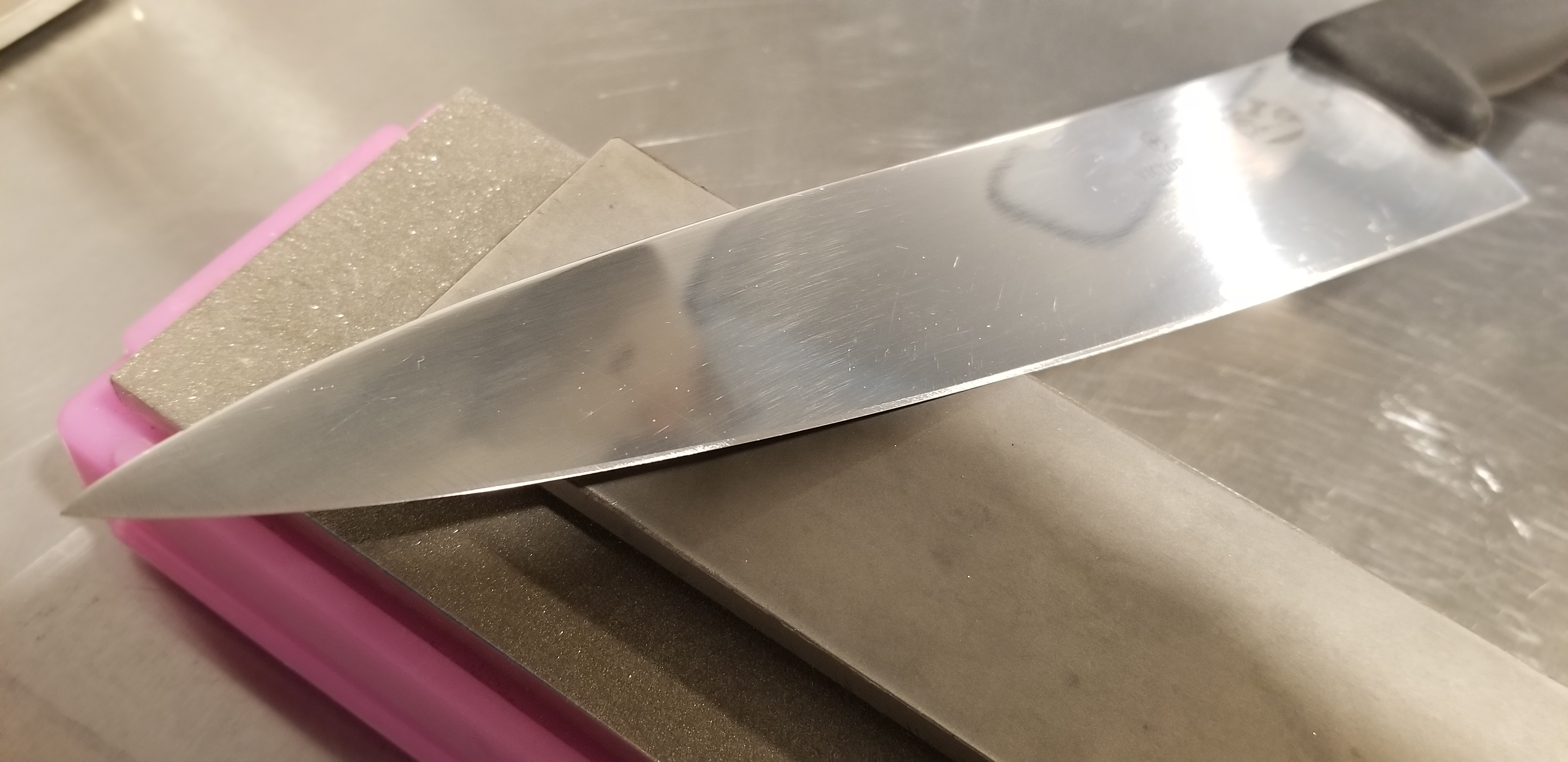

Haven't gotten to test out the kuk yet but did touch up a chef knife today.
30 passes per side on the 140 grit diamond plate, then a couple alternating passes to minimize the burr. Aimed for 10 degrees per side.
Then, aiming for about 12 degrees per side, I refined the edge on a DMT Fine until it caught hairs above the skin.
25 year old stone and a nearly 20 year old knife. Both still going strong.
