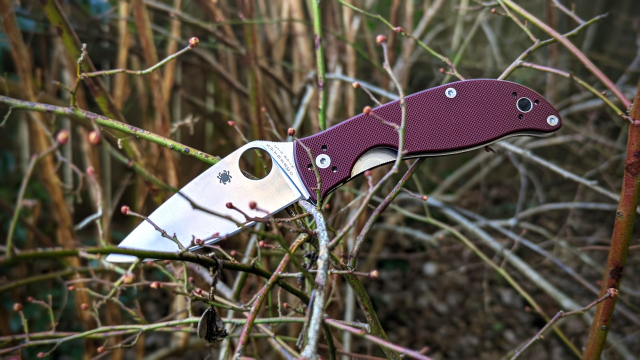

Has anyone experimented to get a vivid lilac/purple? If so, what colour of dye did you opt for? My wife had her dragonfly with wine canvas micarta handle stolen, so this time I’m going to try making her a purple fade handle for her next iteration (mainly because I want my K390 Wharncliffe DF back that she’s ‘borrowed’ until I get her a new one).
