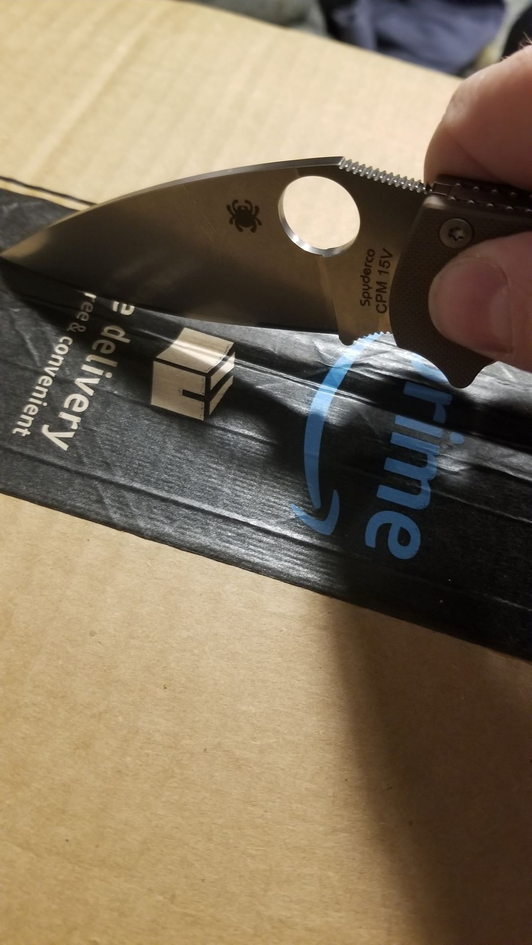

Just got mine in…fit and finish are really spot on. Drops and opens as nicely as my REC and crucarta Manixes.
The factory edge is precisely “working”…nothing more, nothing less. It will cut printer paper with some tooth. I don’t consider that “bad” by any means…15v has gotta be a bear to work with on a larger, manufacturing level.
I’m gonna put my own edge on it later tonight or tomorrow…see how it compares to k390 and s110v on the stones. At the moment I’m expecting it to fall somewhere in between…k390 is really nice to sharpen…s110v isn’t bad, just a bit stubborn. I’ve always found s30v and zdp to be tougher to work with for whatever reason.

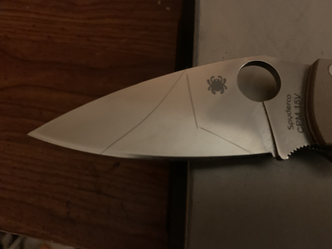

The bevels are pretty even on mine. Set it up out of curiosity on the PA, and it's about 16-16.5 per side. When it's ready to get reprofiled, 15dps on some diamond stones shouldn't be a problem!
Re: CPM 15V Sprint sharpening and performance thread
Do you folks who are measuring factory angles have goniometers? Or using a different method to measure angles?
I just use the old sharpie trick and see where it starts hitting the edge in my fixed angle system.
