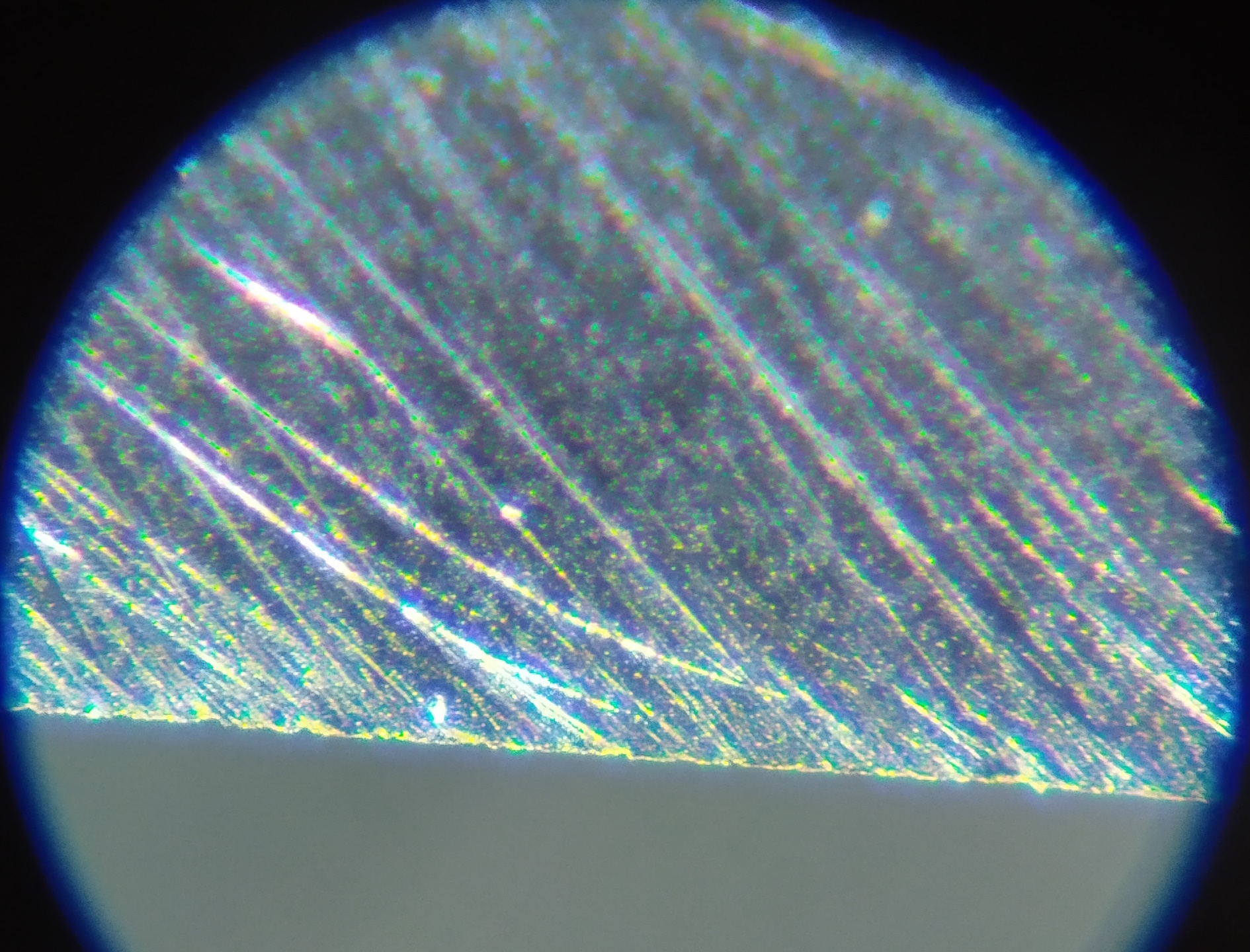

Yojumbo reprofiled to 15dps on a sharpmaker using the diamond rods. Stropped twice per side with 7 micron diamond paste.
My favorite thing about strops is using them to check for burrs. First two times I tried going to the strop one side scraped off more compound than the other, showing me there was a burr my eyes or fingers couldn't detect.
I tried deburring better off the stones two more times before I was happy with the edge. Came off the strop clean with minimal compound on either side.
Extremely toothy but also hair popping sharp. One of my cleaner edges off the diamond rods.

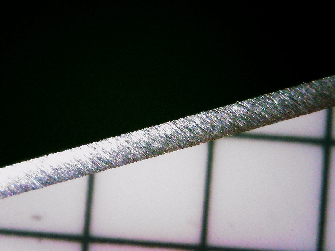

I cut the edge off my Endela and sharpened it again, at work this evening. I keep a Smith's combo diamond sharpener, that I broke all the parts off of so I can just hold in-between my fingers, in my bag. I just use the coarse side, which I believe is 325 grit. Sharpened and deburred on that 325 grit side.
I do find it interesting that the scratch pattern from the 260 grit HF stone looked a lot like the machining "scratch pattern" on the primary bevel, and that the new 325 grit edge looks perhaps finer. It also looks like I might've held an ever so slightly higher angle this time around too...
Might've never known that were it not for the USB microscope.

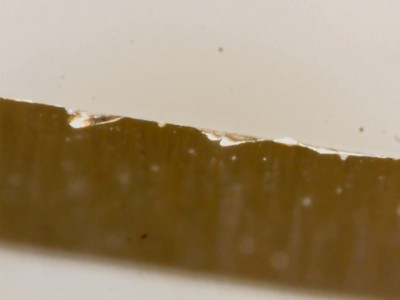

M4 Manix 2 LW factory edge First edge damage not even sure how it happened. You can see the rolled metal starting to tear away from the edge.
