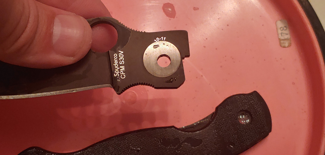

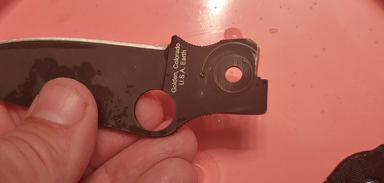

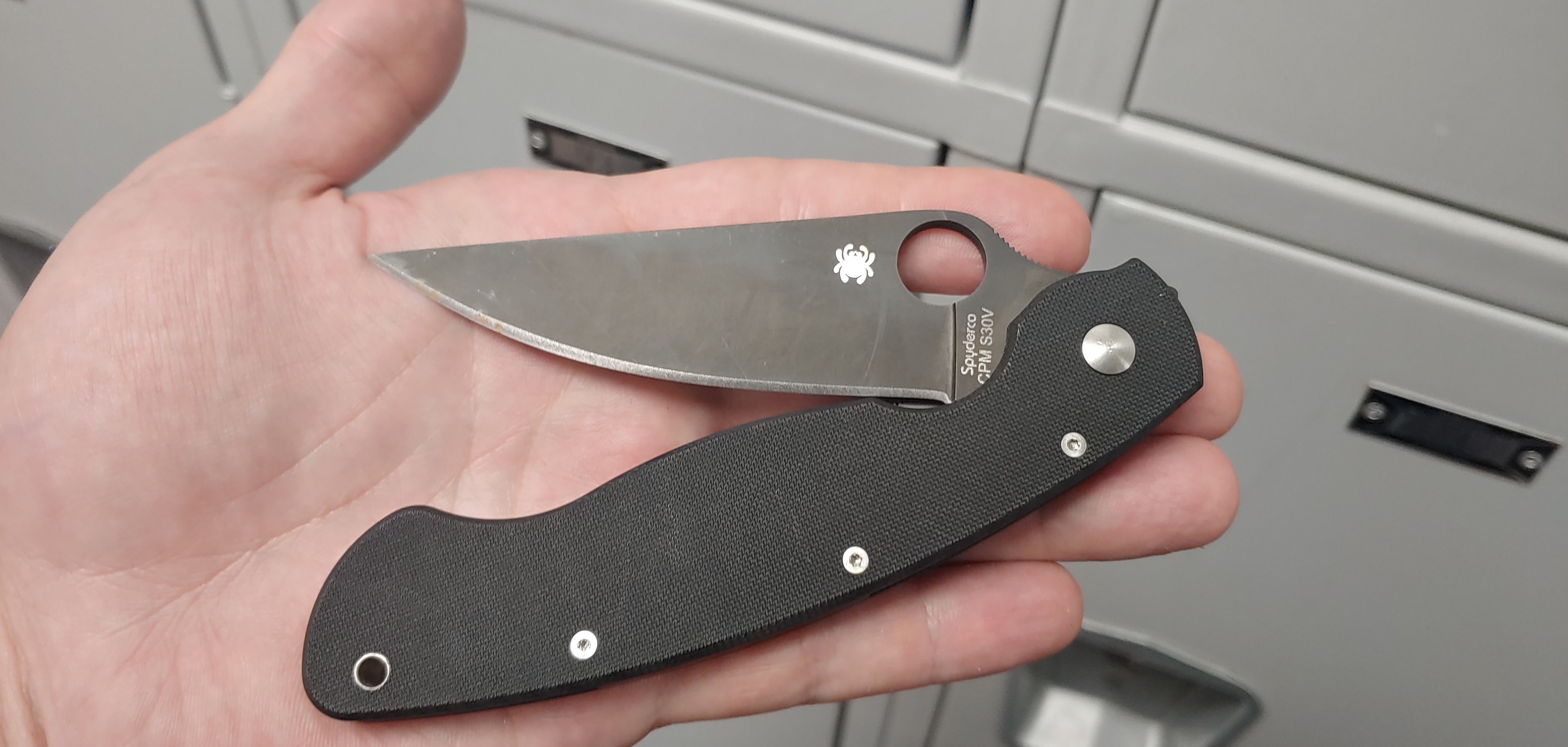

I went shopping for vacation supplies tonight and grabbed a torx set while I was out. Popped open the knife and what I saw didn't surprise me based on past experiences.

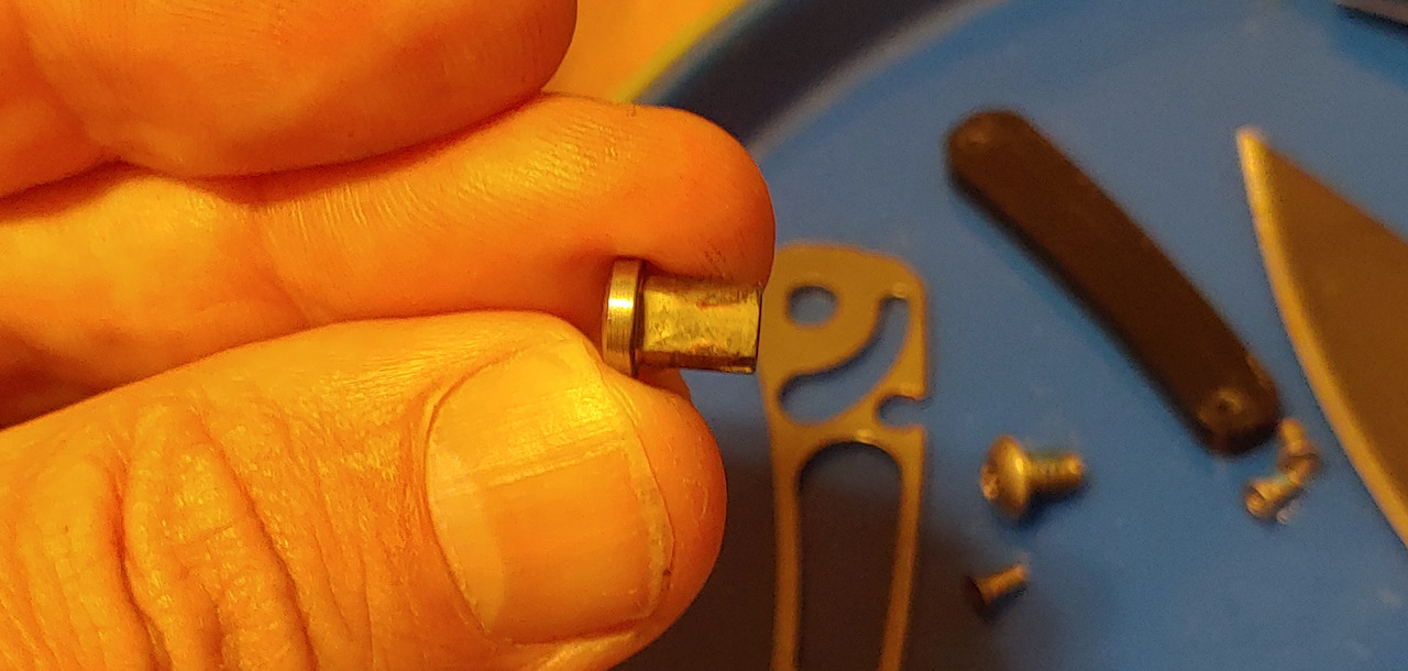

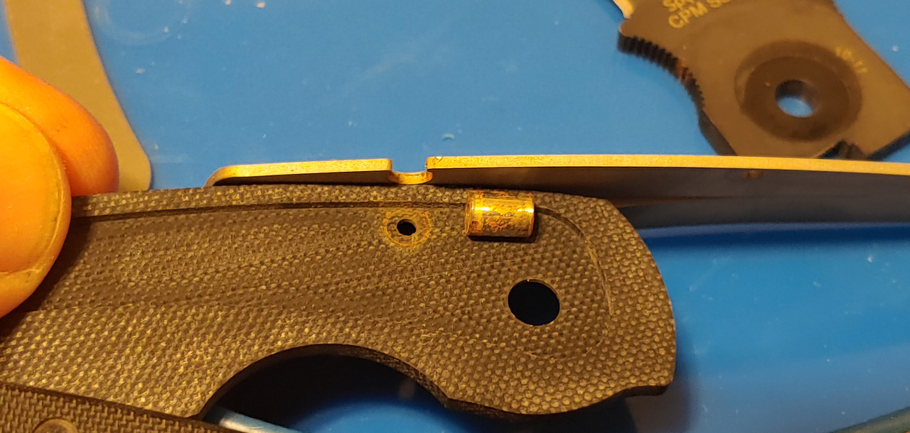

The stop pin rusted. Whatever material Spyderco uses for them has bad corrosion resistance. It's generally the first thing to rust for me on Para 2's and Millies. On my 204p Military the stop pin rusted on day 1.
Then the liner showed some rust where it contacts the stop pin. No surprise.
Bit of rust on the pivot screw. The pivot on the blade looked alright.
Now keep in mind this is from 1/3rd of a single day with one of the most corrosion resistant Spydercos on the market outside of the Salt line.

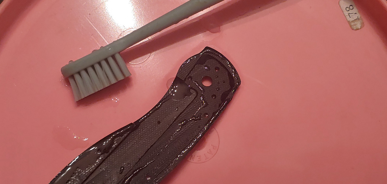

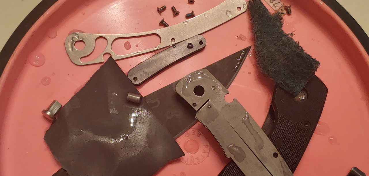

Here's some pictures from clean-up:

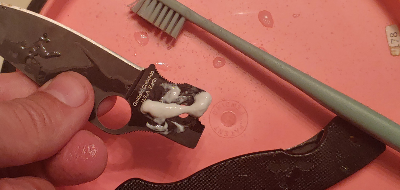

Tried to scrub the rust off everything with an old toothbrush and hot soapy water. Wanted to avoid using sandpaper if I could.
Some parts around the lock interface and inside the pivot hole were being stubborn so I used a bit of toothpaste as a mild abrasive.

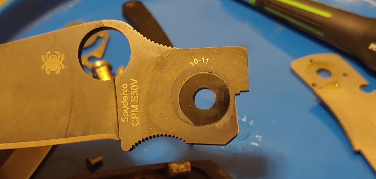

Cleaned up nicely. Only needed sandpaper for the stop pin.

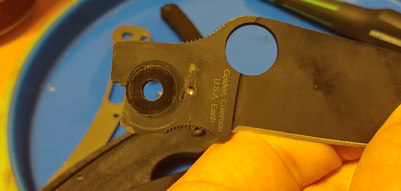

Aside from the lock interface on the blade and the coarsely finished bevel, the only thing that seemed to rust was the stop pin.
The rust on the G10 and liners seemed to be caused by spreading from the stop pin. It didn't appear to be just from salt water contacting the liner (G10 obviously doesn't rust)

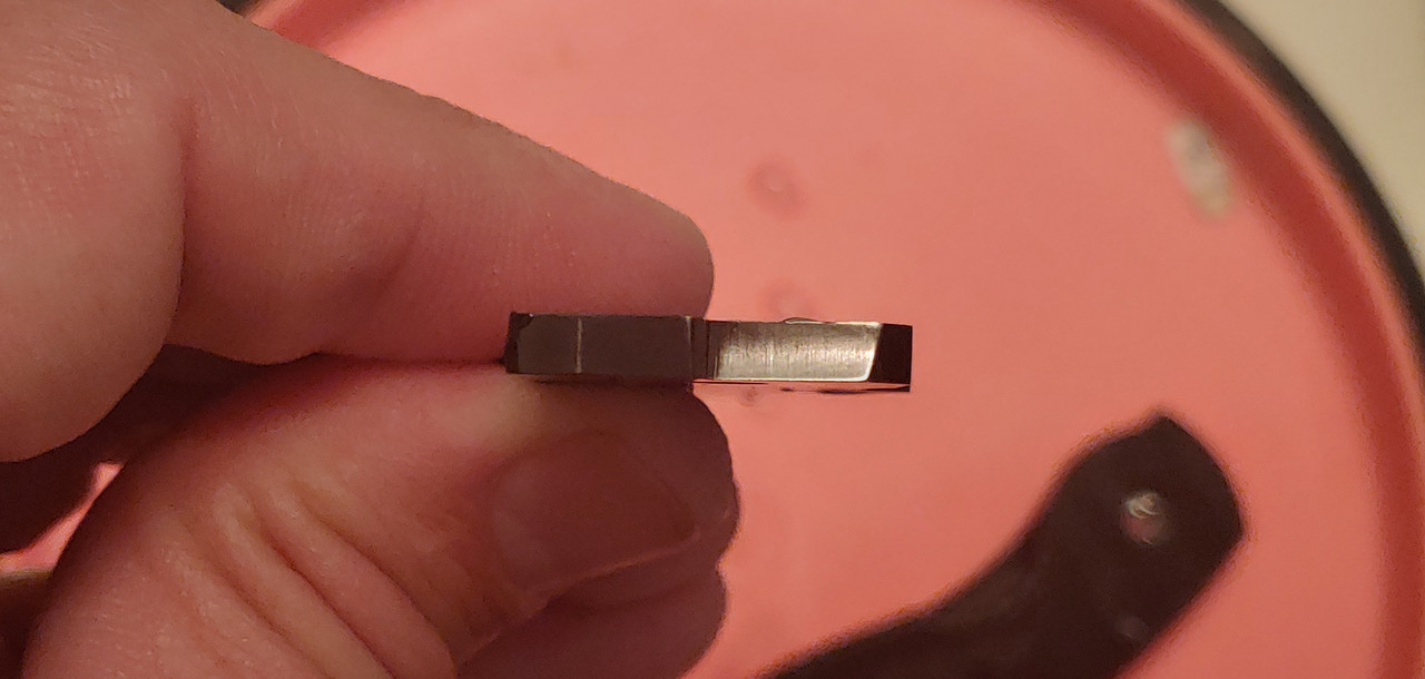

The locking liner showed a tiny bit of rust. The other liner didn't except for where the stop pin sits. They have different finishes and are likely different materials, since the two pieces serve different roles.
Feels nicer than before now. Pivot is a touch tigher, re-lubed the pivot, now I just need to spend a second on the stones getting the last bit of rust off the bevel.
