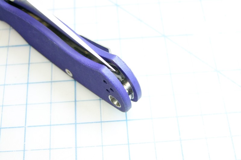

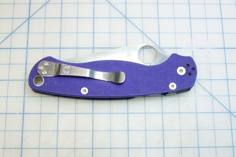

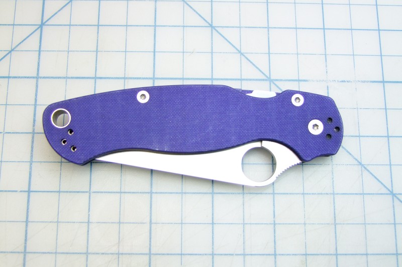

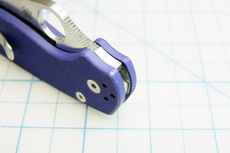

Opps, sorry about that. I meant to update this thread with more recent pictures ...
Update, yes - the dye job is working great. No fading. However, being an EDC, this knife does get bumped/scratched by other stuff in my pockets (I don't try to baby my EDC stuff), so as you can see, in a few places you can see the Blue/Purple is lighter:
I am still happy with the dye job and would certainly do it all over again ;)
