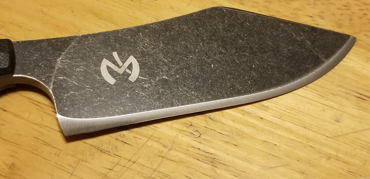

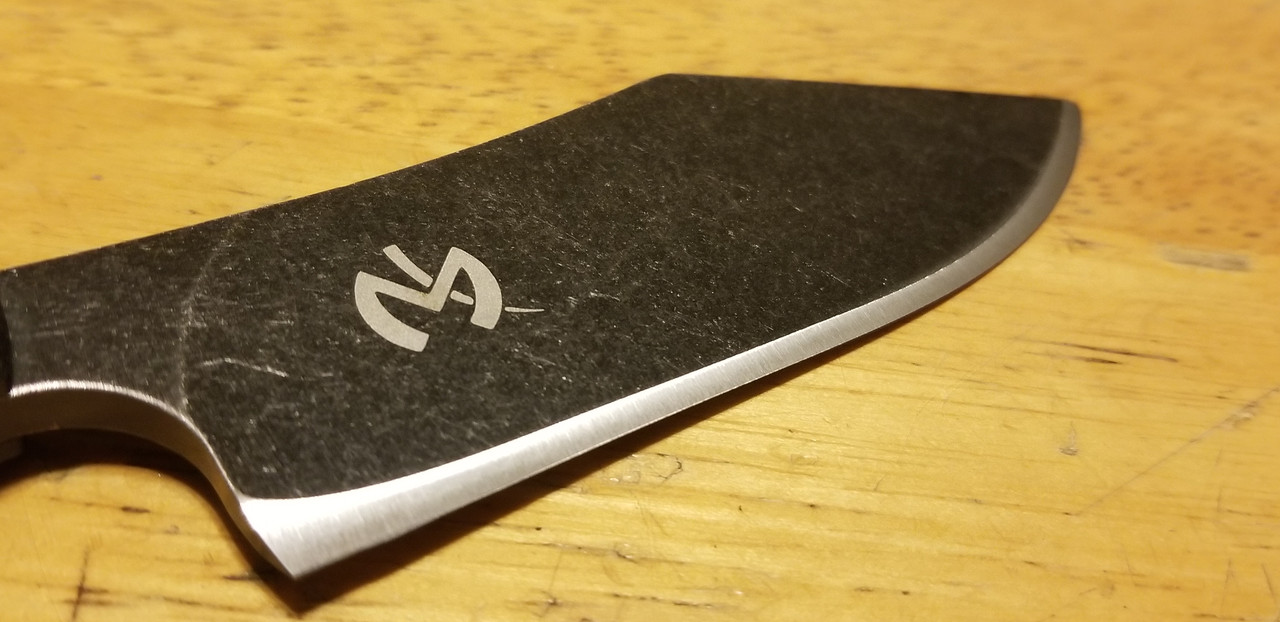

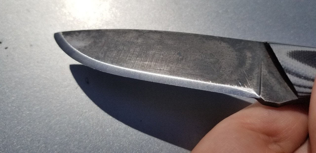

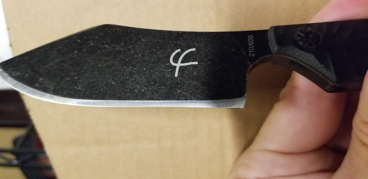

btw heres the perrin le baby bowie ive been working on
it came from the factory with no edge on the first 1/2" or so. I got that part mostly apexed cleanly with my belt sander.
This weekend I'm resetting the entire edge on the sander since currently half has an edge off that and half has a hand ground edge off a diamond stone.
Cuts good as is lol, just looks goofy. Excited to see what I can do on my sander with it later.

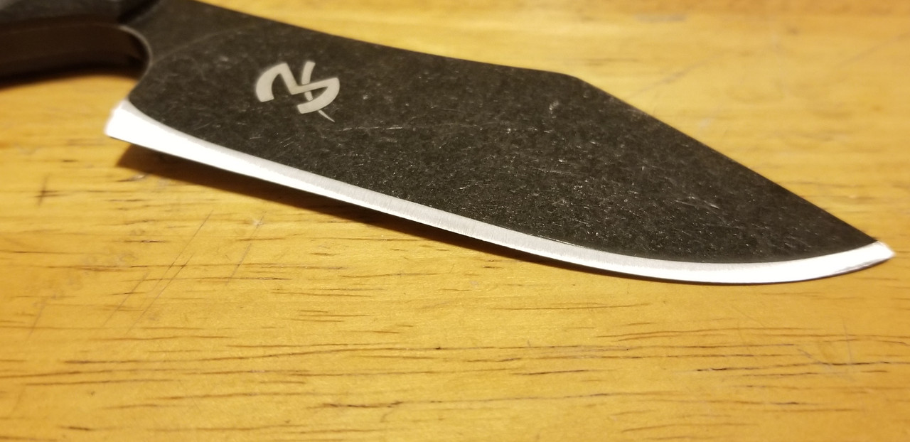

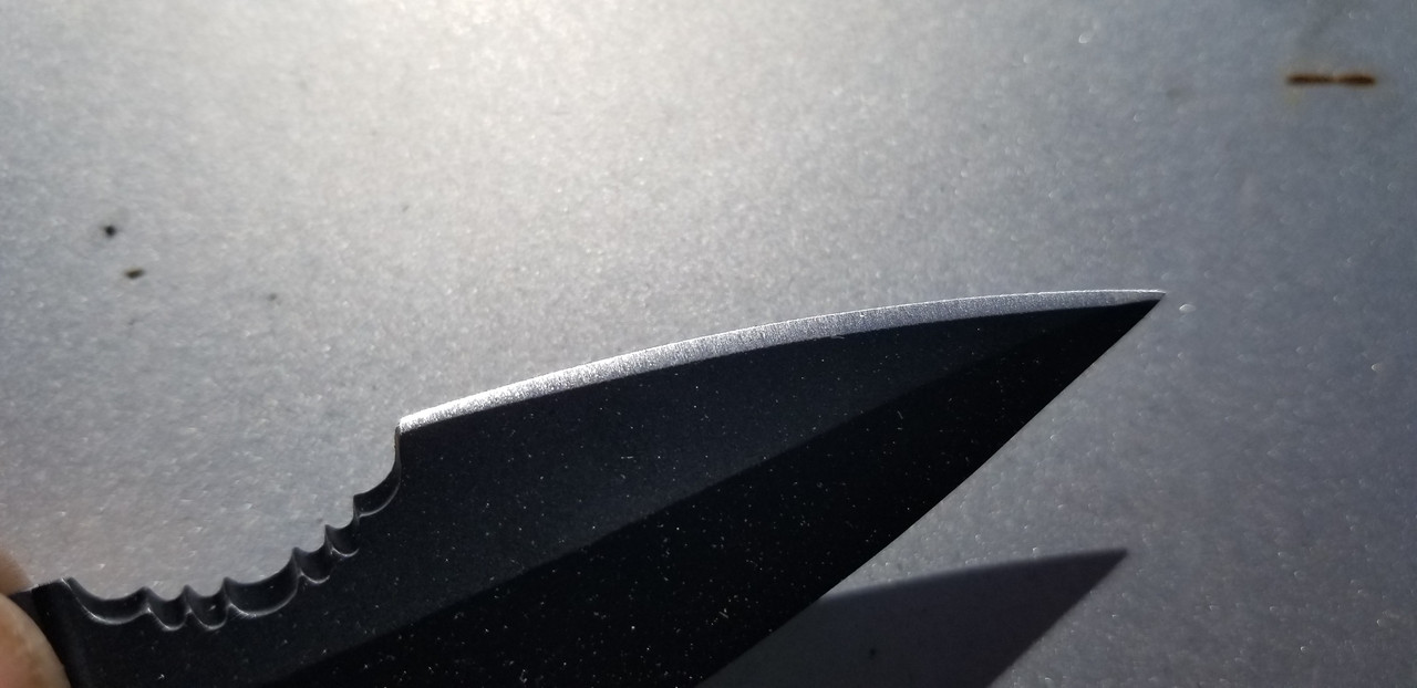

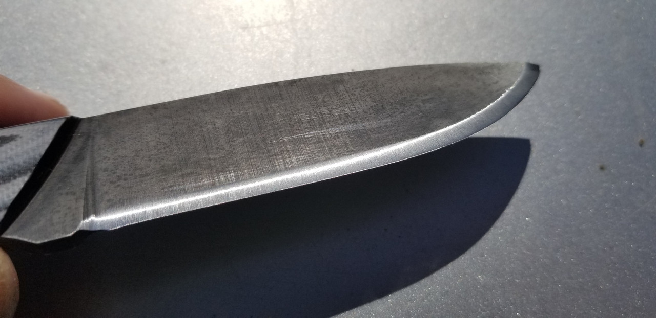

Ok, so not great, but better than the first few knives I tried sharpening with power.
I find it much easier working with larger blades like chef knives and machetes. 3" blades are tricky.
This one came with an edge like the bow river. first 1/2" was as blunt as can be, literally a 3mm wide flat section where the edge should be.
Might not be the prettiest edge but boy does it cut. I cleaned it up with my fine spyderco benchstone, but not so many strokes I sharpened out all the teeth. Can't remember the last time I could wave my knife over my arm without contacting skin and watch arm hairs jump like lemmings. Coarse edges cut and cut but they don't do tricks like that.

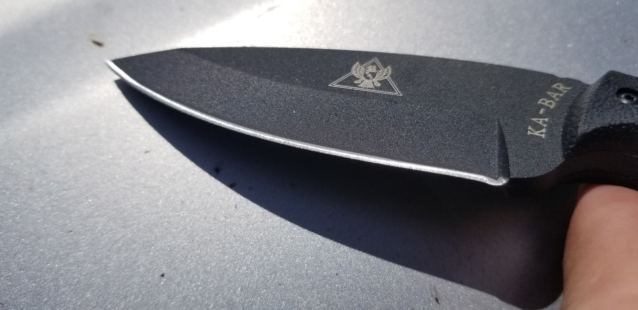

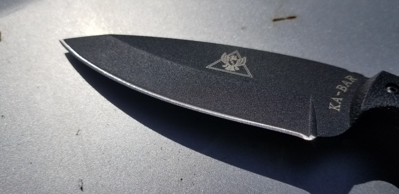

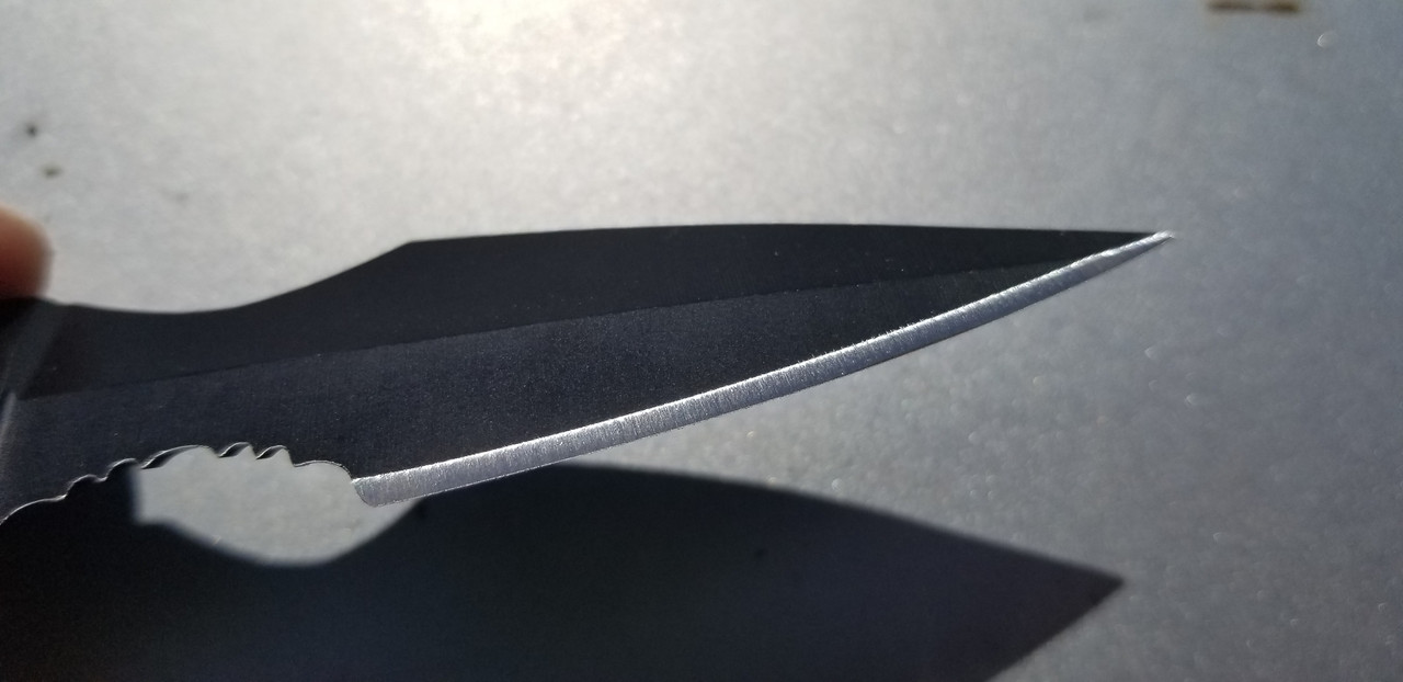

More sharpening adventures with my 1" belt sander.

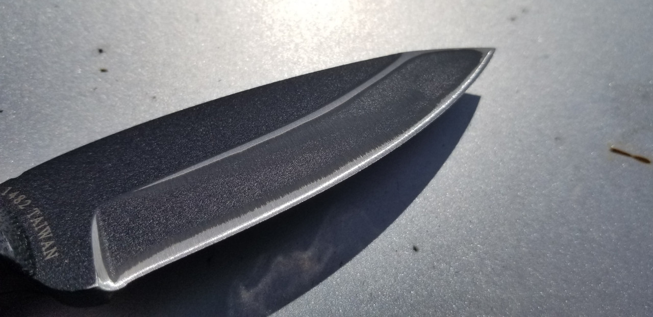

This was one of the first knives I ever tried to sharpen on the sander, a large TDI. Tried to correct the edge today. You can still see scratches from the first attempt. Much cleaner edge now.

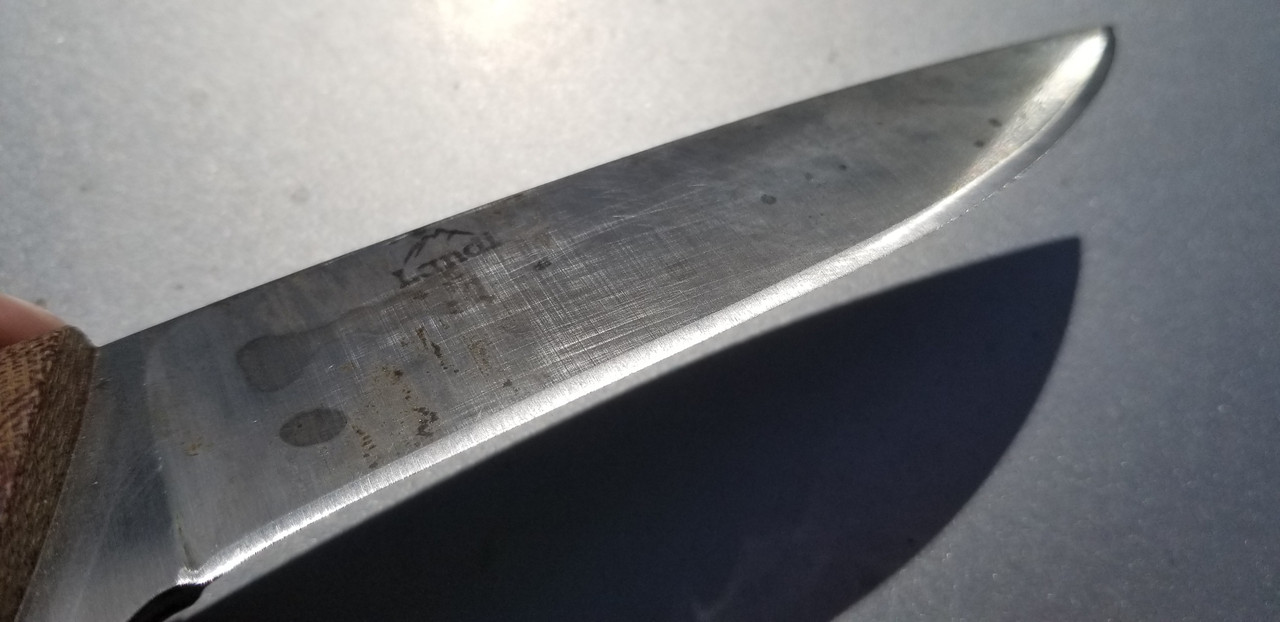

Landi EDC. Carves wood extremely well now. It came with a really thick edge and the steel is hard and tough to grind. Taking this knife this thin by hand would have taken at least 45-60 minutes.

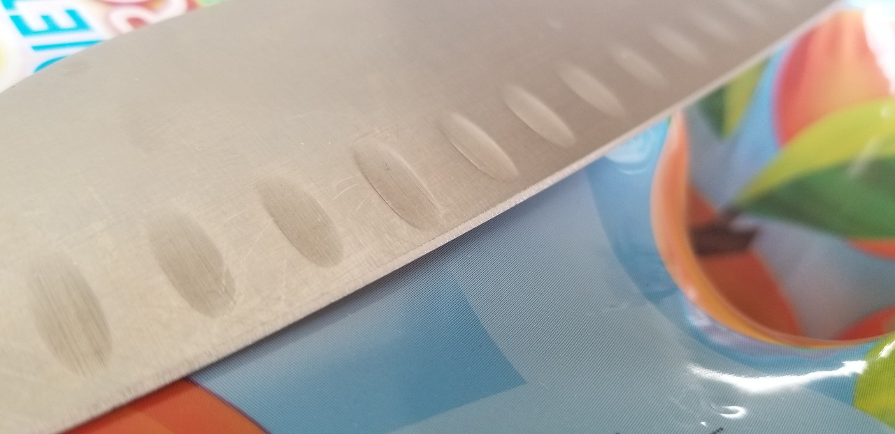

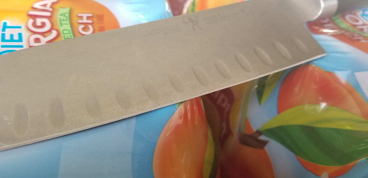

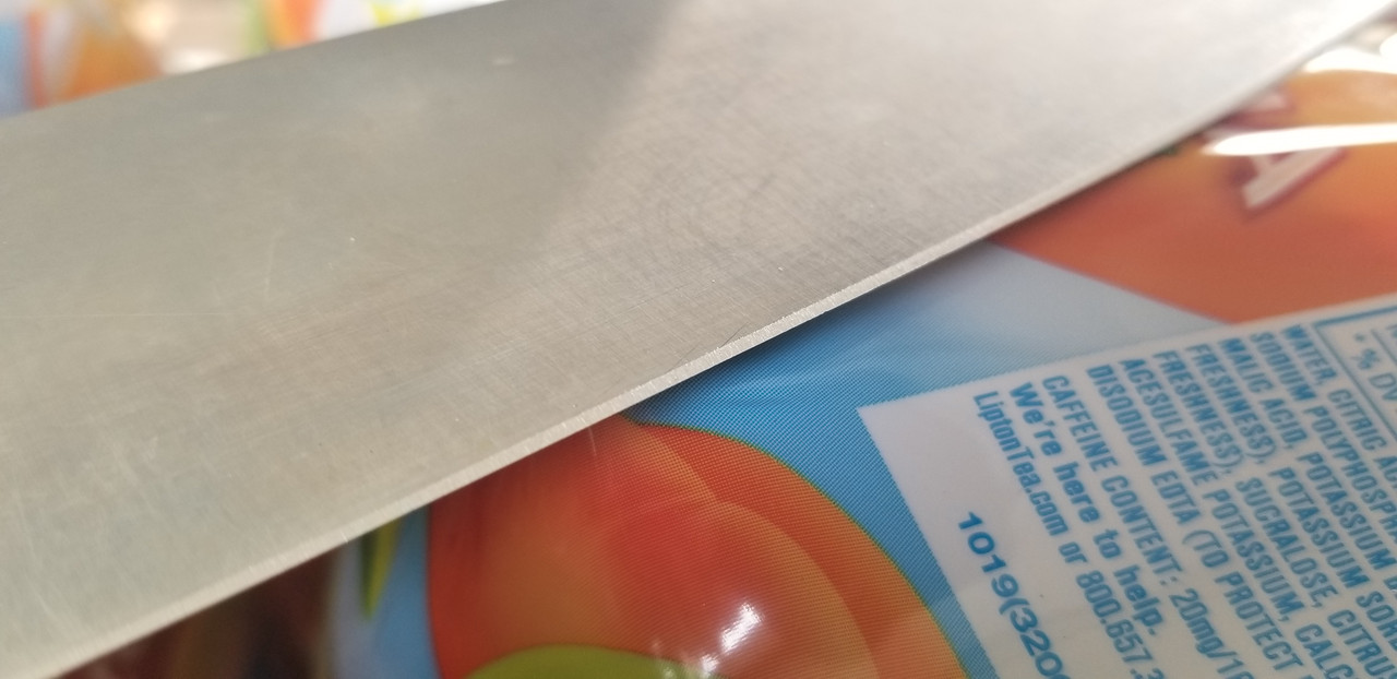

Picked up some of my moms kitchen knives to touch up for her. Here's a henckels santoku:
Like I said before, bigger knives are easier for me to work with on the sander. This one looks pretty close to factory.
Starting to like this method for simple touch ups too, not just reprofiling. I get a clean apex, then give the knife 4-8 strokes per side on a fine ceramic and its hair popping sharp with some toothiness left.

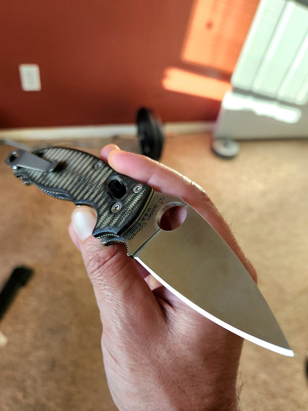

I scored this used for $10.
It was in decent shape. Some patina, a few rust spots, a stiff pivot and two completely dull edges, but no damage and no flaws I didn't think I could easily fix.
I cleaned up the sides of the blades and oiled the pivots, but never did get around to putting a new edge on the blades. Until today:
Took the clip up to 2k grit, and edged the spey on the diamond sharpmaker stones then 1 stroke per side on the fine rods. stropped each on bare leather twice per side. Both blades cleanly shave, but that clip blade took a screaming sharp polished edge.

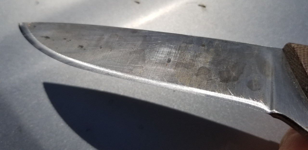

One of the great things about gaining more confidence with my belt sander, is I'm tuning up the edges on knives like this. Knives I bought at one point, but never got around to reprofiling, and so because they didn't cut very well I never carried them.
Went through all my fixed blades that needed a new edge and have been knocking them out one by one. Old chef knives, utility knives, paring knives, machetes, bushcrafters....anything I can think of that needs a new edge.
I've been gaining a new appreciation for knives in the back of my knife drawer I hadn't touched in years. My Landi Bushcrafter came with an VERY thick edge, and the hard steel was taking a while to reprofile. Never got around to finishing it.
Now that it has a crisp, thin edge I refined up to 8k grit, it's been an absolute pleasure carving wood with it. The ergonomics fit me so well. Definitely adding this one to the hiking / camping rotation now.
