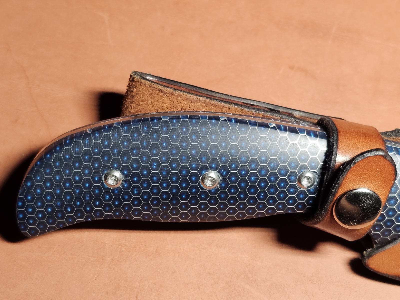

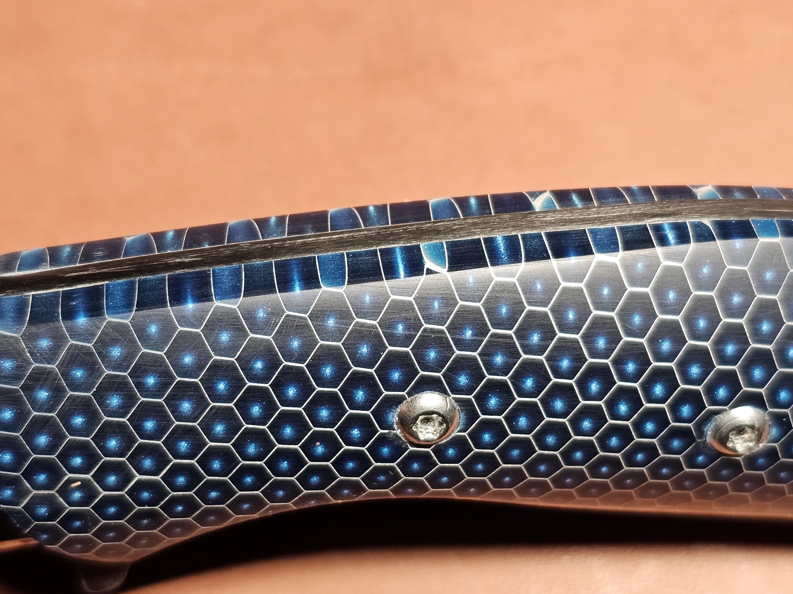

I've been making so many wooden scales recently I wanted to try something different. These are aluminum honeycomb filled with dyed resin.
I think these are my new favorite scales. The way the aluminum honeycomb reflects the light in different angles is hard to catch in a picture but looks incredible irl.
Looks like I need to step back to about 600 or 320 grit in a few spots since I can still see lots of scratches in the pictures that I can't really see in my hand but I think it will be worth it to really dial these ones in.
I've got some red ones like this on the cnc now and will be trying some green after that. It's a slow process with these but I'm pretty happy so far.

That's beautiful. If you wouldn't mind, please tell me about this material?
Re: Show your Mule
Posted: Sun Mar 31, 2024 12:06 am
by FullScaler
Hey Sal,
This stuff is called C-Tek Honeycomb Composite. It is an aluminum honeycomb filled with composite resin. It mills pretty easily but is a bit finicky to final sand due to the different hardness of the aluminum and the resin.
