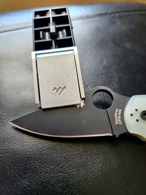

Just picked up a Worksharp Precision Adjust today and was wondering if anyone had tips on clamping Spydercos?
Re: Community Sharpening Journal
Clamp them like any other knife. You want the blade positioned so that the abrasive doesn't contact the clamp itself. Also just clamp the blade itself, don't try to use tape or something else on the blade for protection.Josh Crutchley wrote: ↑Sun Jan 15, 2023 7:32 pmJust picked up a Worksharp Precision Adjust today and was wondering if anyone had tips on clamping Spydercos?
I had one of these. You need to get the stabilizing post for it to be useful. Otherwise there's a bunch of slack in the clamp arm. In the end I sold it and got an Edge Pro. You can get a pretty decent edge off the Worksharp but you're limited to their abrasives. I tried using a universal stone holder but that just throws your angle off every time you change stones depending on the size of the stone you're throwing into the universal holder. The problem with the Worksharp abrasives is the abrasive itself is not flush with the holder, so you can't reach into the rear section of the edge on some knives like the Endura because the holder rams into the choil.

It's kinda weird clamping a Para 3 so I was curious how others do it. Might modify one side of the clamp to give more room for the thumb ramp.
I think I've seen these in the past, looks like a machinist jack right? There does seem to be some play in just about every part of it.I had one of these. You need to get the stabilizing post for it to be useful. Otherwise there's a bunch of slack in the clamp arm.
I already have an Edge Pro type system with some decent stones mostly higher grits. I needed something for reprofiling and wanted to try a cheaper clamp system.In the end I sold it and got an Edge Pro. You can get a pretty decent edge off the Worksharp but you're limited to their abrasives.
Yeah I'm already working on my own stone holder. Might try and split some Venev stones to make them thin enough for a triangle holder.I tried using a universal stone holder but that just throws your angle off every time you change stones depending on the size of the stone you're throwing into the universal holder. The problem with the Worksharp abrasives is the abrasive itself is not flush with the holder, so you can't reach into the rear section of the edge on some knives like the Endura because the holder rams into the choil.
Para 3 is a bit different with the Precision Adjust. You can't fully clamp the blade, but I did mine a few months back like this with no issue and turned out really nice and even. Light pressure is key. No movement, even with it half-assed clamped in.

That's pretty close to the way I clamped mine. So far I've sharpened a 20cv Para 3 and a PMA11 Mule with good results. Ive been wanting to play with some lower grits so I only used the coarse 320 on the 20cv. The Mule I took to 600 and both were stopped with 1 micron paste on balsa. Very aggressive compared to the 10 micron CGSW I typically finish with.

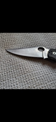

Today I sharpened my Rex45 Native for the first time. In my opinion, Spyderco’s Rex45 is just amazing! It works well with a high-grit polish or a low-grit toothy edge.
On this knife, I re-profiled the edge to 13.5 dps with f80 Venev. I took the time to get a good burr, remove it, then reform it on the other side with the f80.
I then finished the edge with the f150 Venev. I made sure to remove the f80 scratch pattern, and create a fully apexed edge with a burr. I then removed the burr and repeated the process on the other side. To remove the burr, I use a dowl to bend up the burr, then remove it with light edge-leading strokes.
I finished by refining the edge with 10 very light-pressure edge leading strokes, then remove the burr, then repeat on the other side. I repeat the process with 9 strokes… I work my way down to one stroke on each side. All of the strokes in this phase are SUPER light pressure. My final step it to drag the edge through a pice of soft pine and then a felt cube. The result is a SUPER refined and toothy edge that will both slice and shave hair, and last for a long time.
YMMV, but I find a well refined toothy edge to be a beast that does everything I want and significantly outlasts a polished edge.
Looks good!!

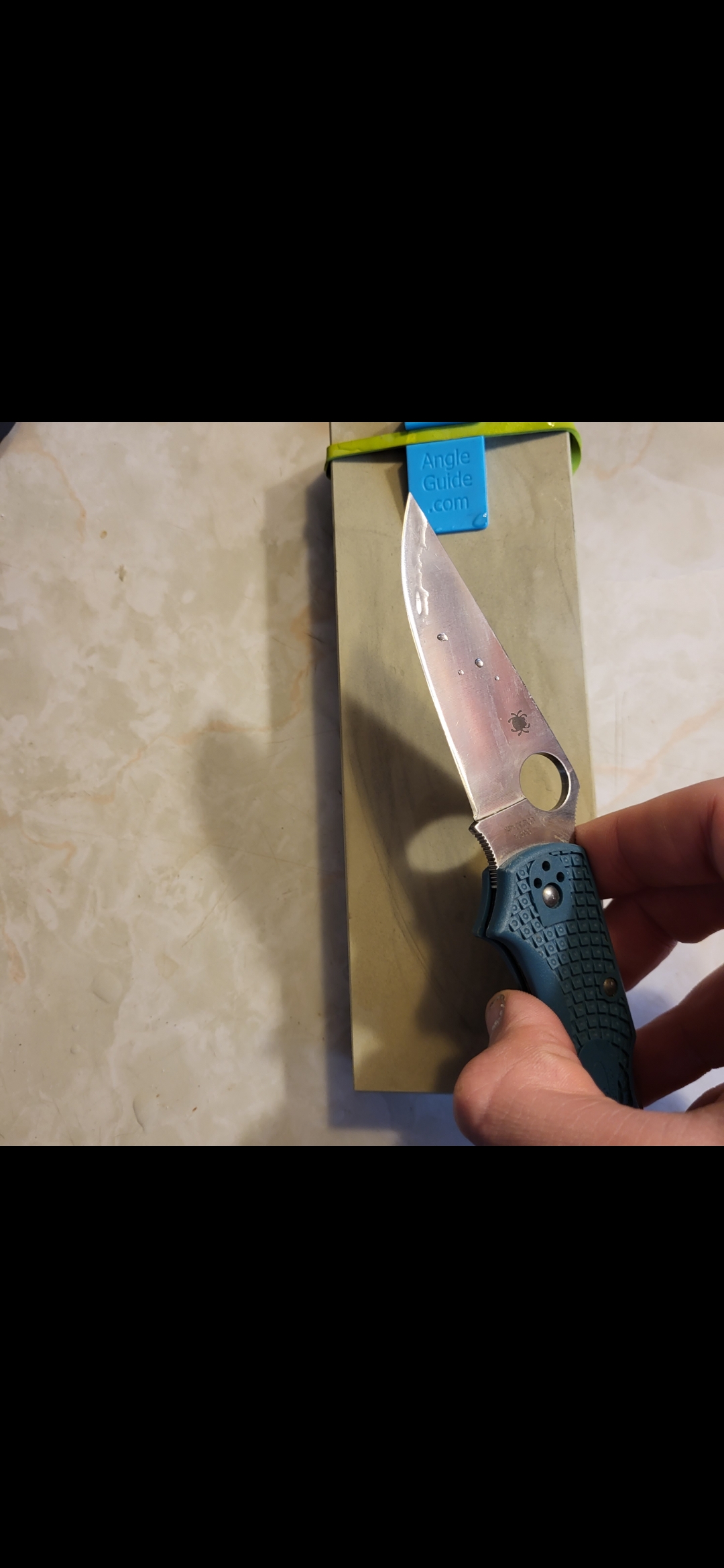

How do you like the F80 Venev? I have the F80+F150 stone but have only used the F150 side since it removed metal VERY quickly for me, even on my 15V Manix 2. I've yet to try/need the F80 but have been curious about it since I've seen a few people comment that the F150 seems to work better than the coarser F80.ncrockclimb wrote: ↑Sun Jan 29, 2023 9:00 pmToday I sharpened my Rex45 Native for the first time. In my opinion, Spyderco’s Rex45 is just amazing! It works well with a high-grit polish or a low-grit toothy edge.
And nice work on the sharpening job! The Venev's leave such a better edge than conventional diamond plates, so when looking for the aggressive toothy edge I find I need to finish with a coarser stone compared to a DMT etc. Coarest I've finished is the F240 and your post has made we want to try ending on the F150 next, but I've got some Edge Pro diamond matrix stones on the way to try out first.

I LOVE LOVE LOVE the Venev stones.
Before I purchased the Venev set, I used the KME. To be clear, the KME diamonds are really nice. However, the Venev bonded diamonds are on another level. This is somewhat subjective, but I find the edge to be more refined vs. the same grit on KME or DMT.
I used the f240 as my final stone a few times. It is great, but I like more tooth. The f150 does that. I find that the super light edge leading strokes combined with multiple burr removals makes a huge difference in the quality of the edge. I spend a TON of time doing this.
I am considering trying to finish an edge on the f80...
