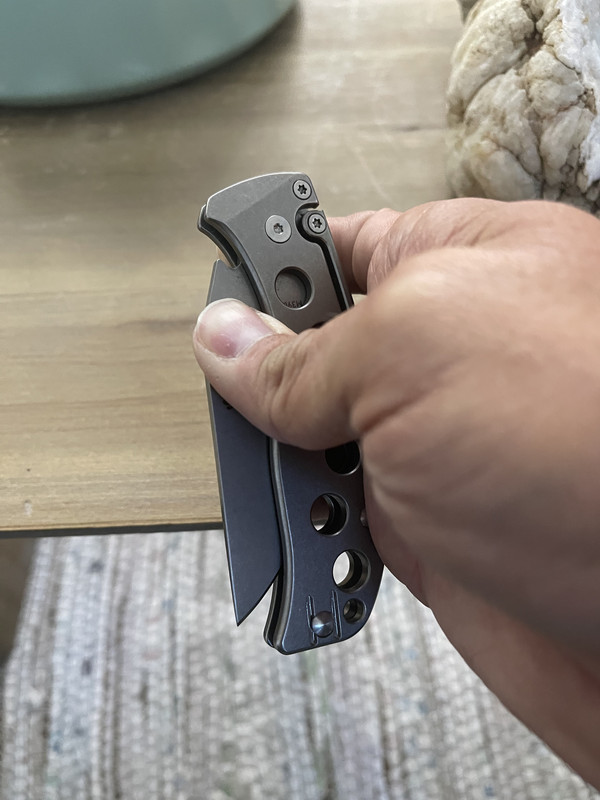

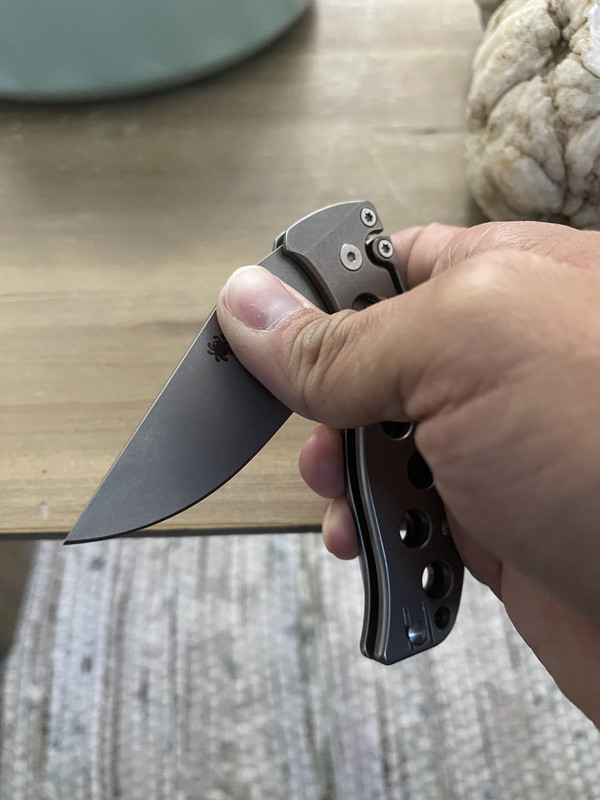

I have a question for you all that have a PITS. Is the action consistent from the closed position to the open position?
The reason I ask is because mine doesn’t open with a single fluid motion. It’s pretty easy to start to open it and when you get it about a half inch or so open (see pic) it hits a wall. When you apply more pressure it overcomes that and then hits another wall when it’s not quite half way open. (Second pic)
The rest of the way it is consistent and smooth.
Just wondering if this is normal, or something that will smooth out.
First “wall”
Second (not as abrupt) “wall”
First “wall”

I have both the M390 and the N690Co PITS. Each behaves the same. They have the first “wall” you describe, but not the second.
The first is the tang’s lower notch disengaging the bolt that connects the two arms of the integral backspring. The blade “locks up” when that bolt snaps into the upper notch. After disengagement, the blade’s resistance should be continuously the same, if my samples are any indication.
As the blade goes from closed to opened, the tang and connecting bolt seem to be in contact through the full range of motion between notches.
Is some surface inhibiting another? Could be grit in washers. Work in a drop of oil. Could be a rough spot or grit on the connecting bolt’s or tang’s finish. Work in a drop of oil.
What happens?

I just checked both my original (blue) PITS and my new M390 version, and mine also have the first 'wall' but not the second.

Thank you for the info. I added a drop of oil to the tang and have been working it back and forth. It seems like the second spot has definitely lightened up/smoothed out. It wasn’t near as bad as the part right at the start.
Thank you for confirming that it’s by design. I was a bit worried something might have been wrong and I didn’t want to continually open and close the knife and cause damage while trying to smooth it out.
I was actually trying to look in at the notch in the tang to see if there were two notches, but it’s hard to tell. I have quite a few slipjoints a but have never felt one with this action before. They are generally a constant tension throughout the movement. Could this be because of the round interface, whereas most other slipjoints are squared off?

Re: 2022 P.I.T.S Sprint!
With the knife closed, you can actually see both notches. One is what the connecting bolt sits in to keep the blade closed. The other is the thing in the blade between the Spydiehole and the pivot that looks like (but isn’t) a bottle-opener.Ranger_Ike wrote: ↑Wed Aug 17, 2022 8:29 pmI was actually trying to look in at the notch in the tang to see if there were two notches, but it’s hard to tell. I have quite a few slipjoints a but have never felt one with this action before. They are generally a constant tension throughout the movement. Could this be because of the round interface, whereas most other slipjoints are squared off?

Been working the action quite a bit today and it has gotten quite a bit smoother. The first “wall” is not near as abrupt or hard to overcome anymore. I’m so glad I jumped on this before they ran out.

The bar that ride on the blade does need to be lubricated while in the break in period, otherwise you get that dry, metal on metal galling.
I also noticed that the blue model has noticeably thicker blade stock. I'm not sure if that helps or hurts in the smoothness of opening. My older blue model is smoother with a lighter action. Could be due to more opening cycles or to the stock thickness, or to something else entirely. Just an observation.

Ranger_Ike wrote: ↑Wed Aug 17, 2022 6:08 pmI have a question for you all that have a PITS. Is the action consistent from the closed position to the open position?
First “wall”
I only have the first "wall" after I disassembled, cleaned and (fluorinated CRK) greased the pivot area. The first "wall" won't go away, it is the shape of the tang.
