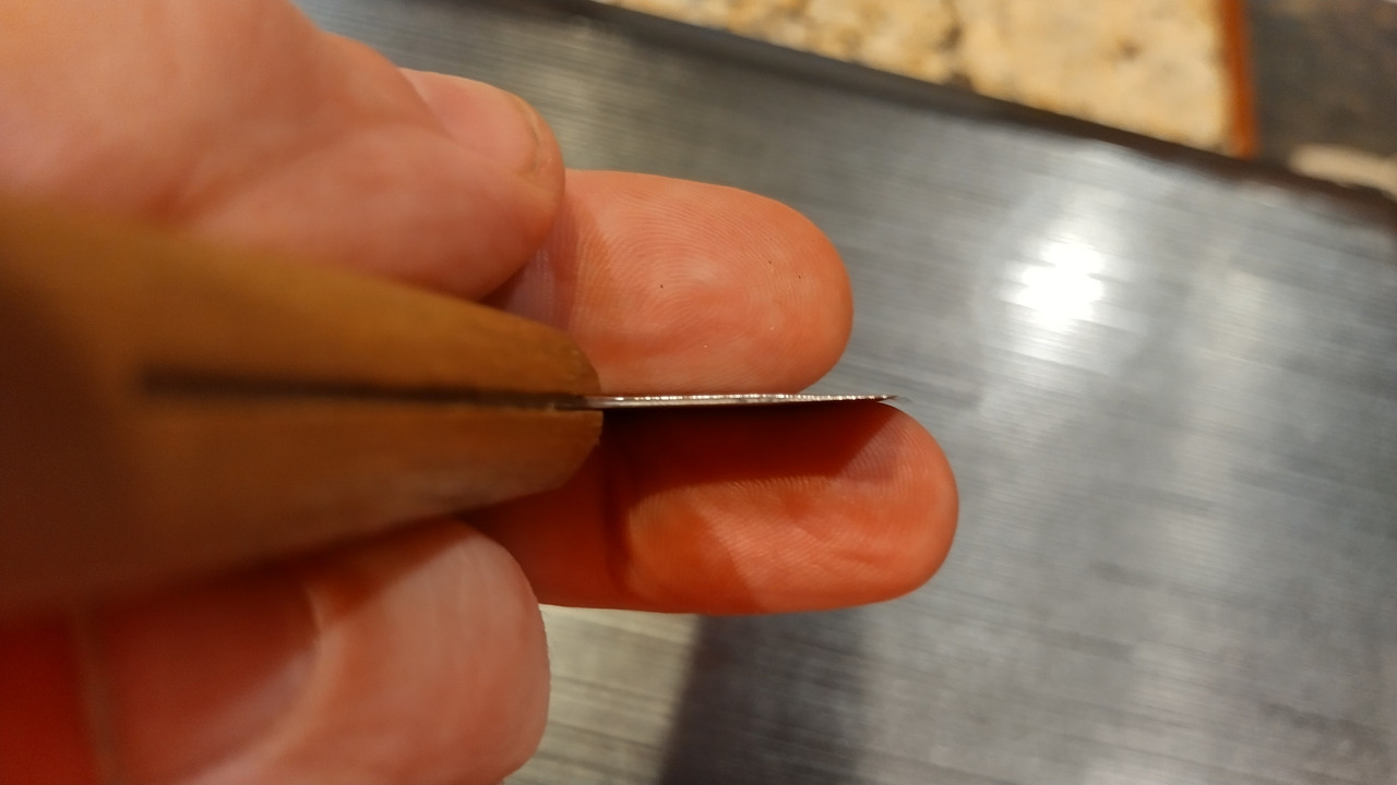

everyone here needs to try one of these. 1mm stock, extremely thin bte, steel takes a razor edge effortlessly. folks out there cutting up food with your 3-4mm thick folders, you're missing out.
I've got a few of these scattered around the house and my restaurant. This one I did a few strokes on the diamond rods at 15 degrees, then medium then fine at 20 degrees. The steel is kind of soft so I use 20 instead of 15 with this brand to help avoid having the edge roll.
Crazy high performance for $5. Really shows off how much geometry matters.
Posts: 13861
Re: Community Sharpening Journal
#1564
I bet that's a lot of fun to work with, that's silly thin.

I feel like you could turn that knife over and still cut things with the back.
Do you do the diamond and medium at 15 and the fine at 20?
--Pete
Posts: 17042
#1574
Nope, set the edge at 15 withh diamonds, then refine at 20 with the ceramics. The whole process only took about five minutes. polishing full bevels is a waste of time IMO, only the apex needs polished for good push cutting.
Perfect, Thanks!

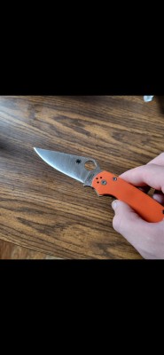

Post by Steeltoez83 »
