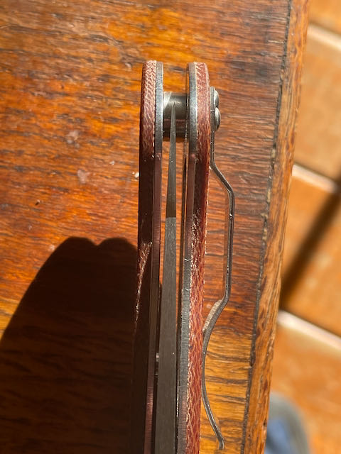

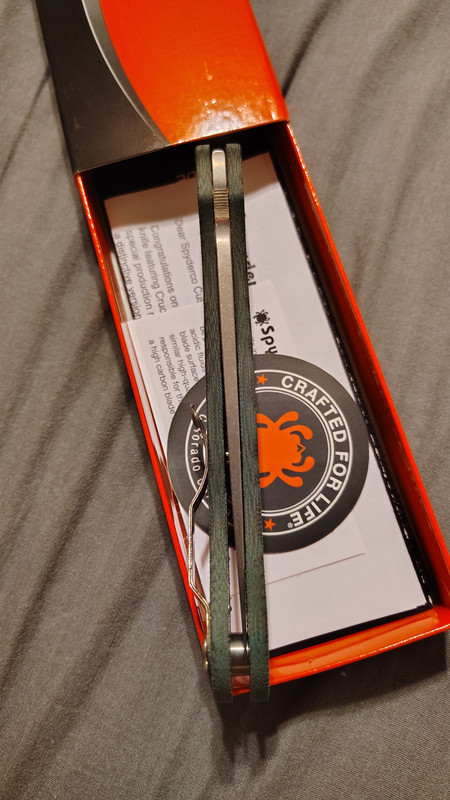

The knife will quasi-center but the pivots can't be tightened. It seems ridiculous but maybe Locktighting the loose pivots.
I've tried changing the clip positions, taking off the clip, centering over to the opposite side. But the knife simply favors the one side in the tightened position.

It's being stubborn but seems like loosening the clip screws made a big difference. At least it's centered before tightening everything. And I could feel the blade moving during tightening of the pivots.
Also there was a slight bend in one of the liners. I tried to correct it.
So I'll try again a little later because I have to run.
I appreciate the detailed help on this. I think I'll at least be able to get it to an acceptable degree of centering now. And the action feels better than ever if I don't get it to tight. Man this one is like walking a tightrope compared to others in my collection.
Many thanks!

I have had it apart twice so another won't hurt. I'll check for irregularities. In this case I have noticed that adjusting the main pivot screws, or any of the other screws for that matter, doesn't make any difference to how the blade centers. You just get what you get.
I'm learning a lot from the members. I'll post a follow up to what I find.
Thank you!
-skybladefromthe
I only have one knife in my collection that I can't center, and the construction of that knife makes it pretty much impossible (Rock Lobster).
I loosen all of the screws around the whole knife (clip screws too because they're holding the scale in place against the liner). You don't want to remove them just loosen them.
Then depending on what side your blade is off center, hold the knife (while closed) in your hand and literally bend it like you're trying to break a stick in two. If you watch you'll see that the blade moves left or right depending on which way to bend the handle. You need to bend it so that it pushes the blade in the opposite direction of where it's off center, and then start snugging down screws at the same time. It helps if you have 3 hands lol.
Some people try to wedge folded up paper between the blade and inside scale and that might help but what's happening when you bend the knife is you're shifting all of the parts around in/out of parallel with each other, and you need to bend it so that it's straight and then snug the screws down.
I usually try to bend/press the knife into my thigh and use my other hand to shut down the screws. I'd start with the body screws and then work around to the pivot screws. On a Military I can do this one handed because the handle is so long, just hold it like this and you can squeeze it and you'll see the blade move side to side, then hit the screws with your other hand.
I'm one of the last people you'll hear complaining about blade centering because this has only ever not worked on that one Rock Lobster, and that knife has almost no gap between the blade and liners so it almost doesn't move when I try this method. But I do this all the time with a lot of knives and it works.
I have a 15V Mili 2 that was off center in a way that was almost identical to yours (blade almost touching the handle). I took it apart and removed the liners. The show-side liner was slightly torqued. You couldn't tell until you removed it from the handle. But I straightened it out the best I could and reassemble it. Now, it's not perfectly centered, but it's close enough.

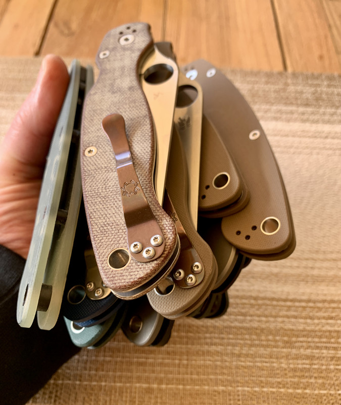

A handful of Militaries (14)...
Half of them (7) are Military 2's. How did that happen? 😬

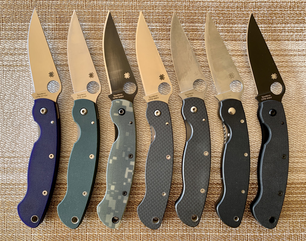

I still carry a few M1's regularly! Here they are.

A minor difference I noticed today when I handled all of them back-to-back. None of the M1's had any lock stick. All of the M2's had a bit of stick... 🙂

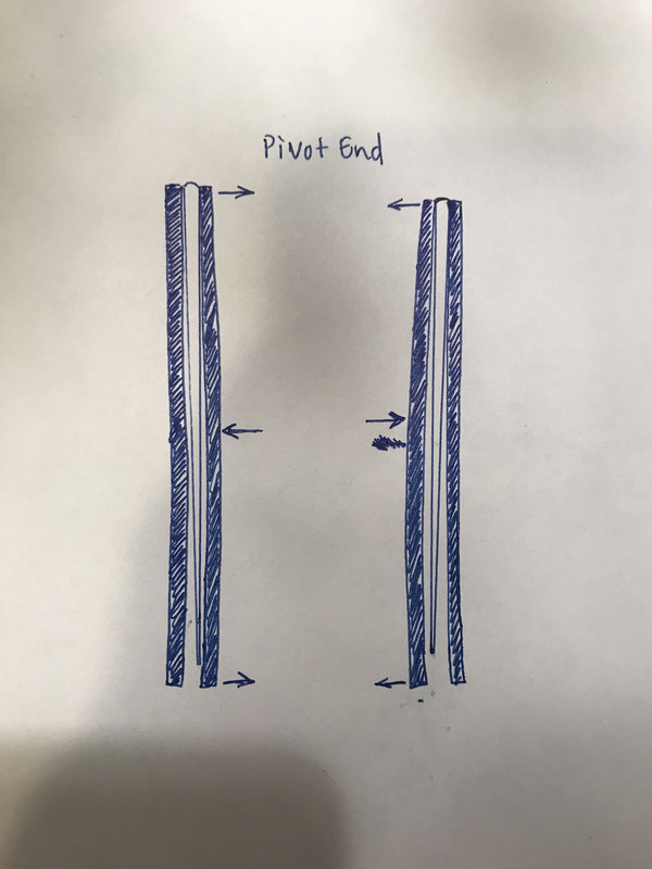

For anyone with centering issues with their M2, I posted this a while ago in the chief LW thread... Hope it adds a helpful dimension. As was said somewhere above, sometimes you need to flex the scales/liners.
This is what I’ve done to center blades on my lightweights.
Loosen all screws, apply force (see arrows) to bend knife according to whatever side the blade favors. While applying such force, fully tighten all screws. Back off pivot and lock bar screw as needed to allow smooth action. If this fails to center the blade then fully remove scales and bend them with force applied in the same directions, put knife back together and check centering. Sometimes this over corrects the issue. Take apart, bend and adjust force as needed until centered.
I realize this is a kind of involved guess and check game, and we shouldn’t have to do this. But if you want a centered blade, this process always works for me. Sometimes the scales aren’t perfectly straight from the factory

This helped me.
I took apart the knife and bent the liner as shown on the diagram. While there is still a favoring to the show side it's better than it was and all the screws are tightened down. The action is good.
I may be able to improve it further if I gave it another try. But I'm ok with it like it is for now.

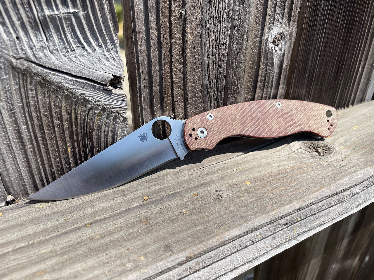

I went ahead and ran through Drubieg's liner bending process again and the used a bit of blue loctite to finish it up. I spent a few hours trying different things but this was what ended up working out for me.
Thanks all for the assistance. This is a really good forum!
Here's the result...
Glad it helped!
Heck yea dude looks great
