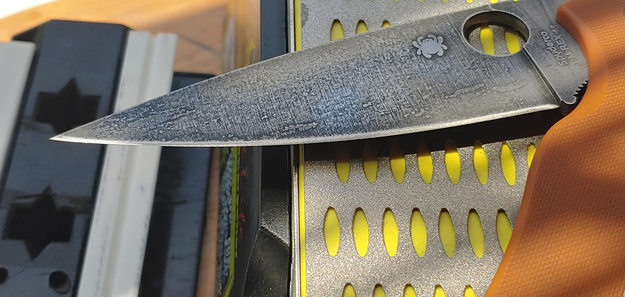

My daughter(Army) brought in her V-toku2 Endura for me to sharpen. I asked what she had been cutting with it, and she said "C4 and det cord". Lol last thing I cut was the wrapper on a snack cake. Anyho, only had to use the white side of my cbn doublestuff and then strop.5 minutes and good to go. I really didn't care for V-toku when I had the knife, but since its gone through 5 or more sharpenings, it really shines.
Also touched up her hb ladybug.
