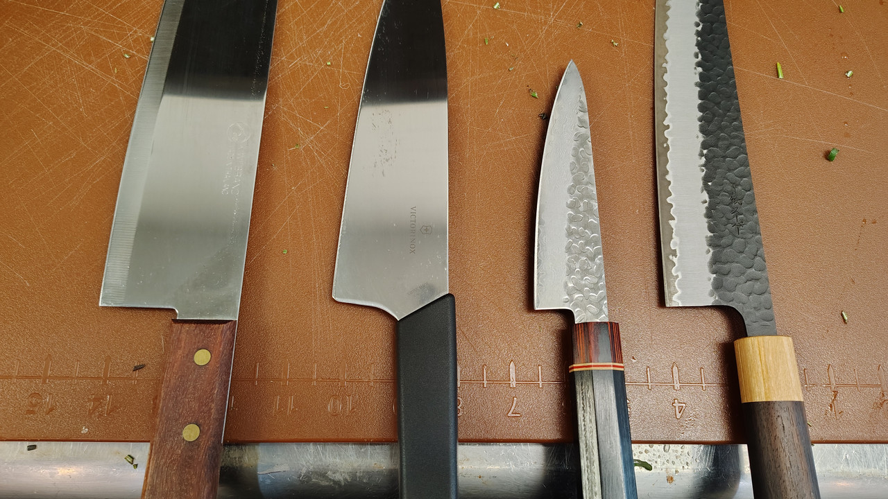

I would go with 2mm stock, 8" length, typical chefs pattern shape, and 1" minimum knuckle clearance. I like 1 & 1/4" better myself.
edit: this may help. my most used knives plus a standard victorinox modern 8" chefs.
those are 1" markings on the cutting board.
Another detail that I prefer is a sharp heel. I use it to help peel whole onions, halve avocado and remove the seed, etc.
