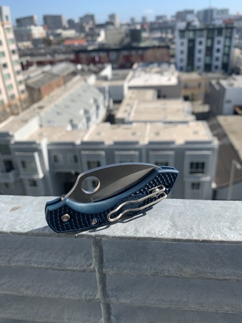

Had some Sapphire Blue dye and decided to give it a shot and see what it would do to a Vtoku2 Endura and Manix2 lw Maxamet grey. Just to compare the results of the coloring I laid them next to my BBS m390 para3.
Also dipped the hb for a change of scenery :D I didn't remove the blades at all and used the methods mentioned in this thread but didn't use vinegar at all. The Endura took less than 30 seconds to achieve the color above and the Manix2 took a couple of minutes longer.
The Maxamet blade ended up getting some light pitting but it's a user as well so didn't bother me....much. Still happy with results. :spyder:

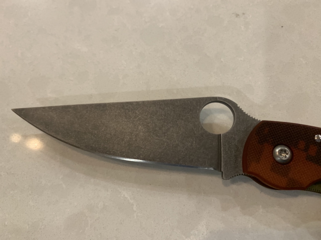

Got some better natural sunlight shots of this Sapphire Blue. Funny how the tops of the black G10 look teal in certain lights.
Not sure if that has anything to do with dye, they're definitely black when not reflecting light.

Yeah that's all I've been using for G10 these days. I prefer the liquid anyway but I tried a box of regular black powder and it didn't take at all. The Sheepscliffe (wharniesfoot?) is the best blade shape ever.

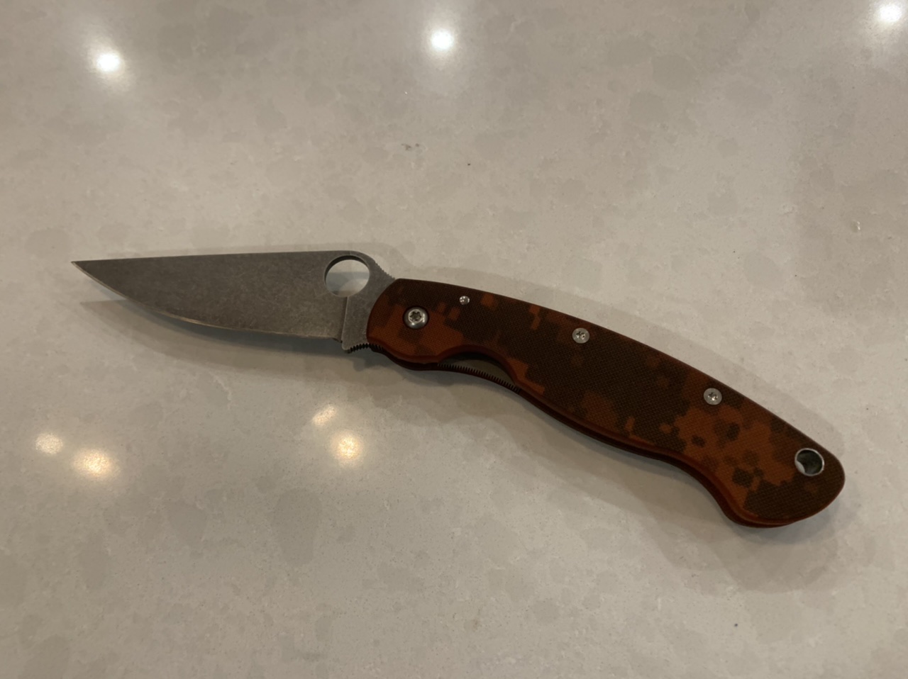

Tried my best for orange but either the concentration was too weak to do anything or it came out red. I stripped and repeated a couple times which acetone makes surprising short work of. Anyway, I followed up with a little acid etch and Gatorade bottle stone wash and thought it turned out well enough to share.

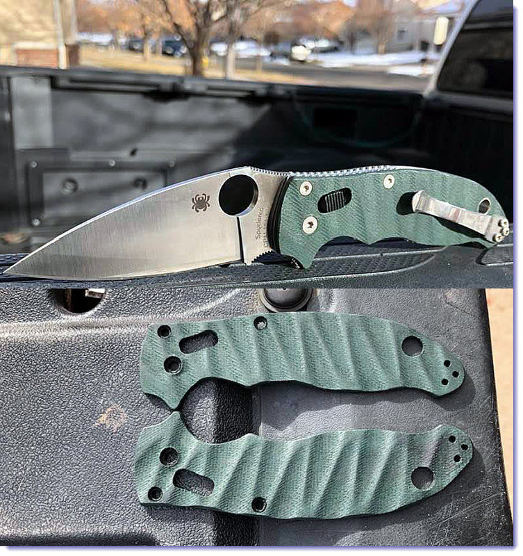

Project for this weekend completed; Rit Dyemore Peacock Green & Vinegar on previously Brown micarta scales for the CPM154/S90V.
And Earthbrown M390 scales on the DLC S90V (ala TKJ Cruwear Shaman) I like how deep the green came out on this Manix :spyder:

Ok, this one is impressive. Surprised how well the green came out over the brown!

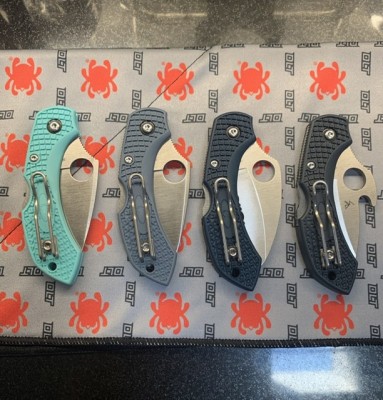

That DLC/Green Manix looks great! I've been meaning to do mine for a bit now and haven't pulled the trigger over concerns of it coming out too dark. Just tried to make my DF Salt HB a Smurf blue to add some brightness to the blue-ish variants but ended up with darker than I hoped, may try again with a light green dye and see if it come out brighter.

I'd take a look at the different shades of green that Rit offers and go with the lightest, as stated went with the Peacock Green; I had seen a posting on fb from a person that had done it and I loved how dark forest green the scales came out.
