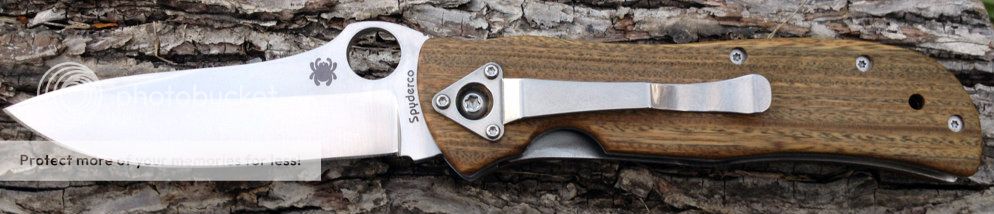

OldSarSwmr
Posts: 1084
Joined: Sat Jul 23, 2011 9:00 am
Location: Richmond, VA
#1079
Post by OldSarSwmr »
BOWA, the cork looks awesome! Very nice re-purposing of materials.
My Starmate in Lignum Vitae is complete.
:spyder:
Dan
