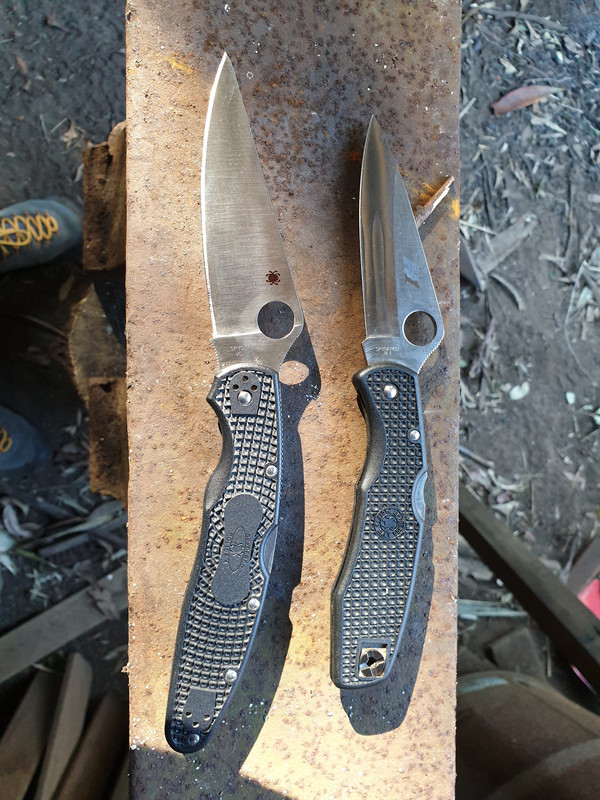

I have been very interested in the P4 lightweight but conflicted about whether I wanted K390 or VG10. I love K390 but have had rust issues with my Endura and the P4 will see frequent use for food prep in the bush. I actually really like VG10 and have found it superior to LC200N in every respect apart from extreme rust resistance. In the spirit of this thread I decided to go with the VG10 and will try it with different edge angles and finishes.
This is the Pac Salt and the new Police 4 lw.
So far it is around 15dps, finished with the brown rods and is performing well, much better than with my old way of more polished edges with VG10. I know you have the same P4 Vivi and I was wondering what sort of edge angle and what grit finish you are using with it? I love the extra edge length of the Police compared with the Pac Salt and this is so much better balanced than my G10 Police 3.

I've got three P4's at the moment.I have been very interested in the P4 lightweight but conflicted about whether I wanted K390 or VG10. I love K390 but have had rust issues with my Endura and the P4 will see frequent use for food prep in the bush. I actually really like VG10 and have found it superior to LC200N in every respect apart from extreme rust resistance. In the spirit of this thread I decided to go with the VG10 and will try it with different edge angles and finishes.
Dan
