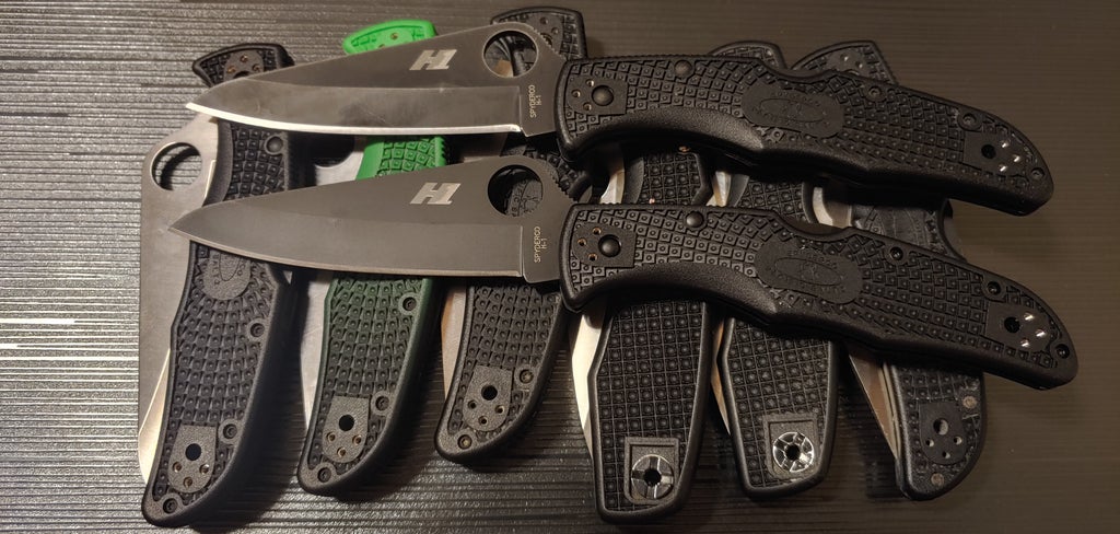

Post by brj »
Spot the intruder ;)
cabfrank
Posts: 3477
Re: Pacific Salt praise
#110
Post by cabfrank »
Atlantic. Nice collection. Any favorites?
brj
Posts: 1036
#111
Post by brj »
The FFG ones. I've found thin FFG H1 to be amazing for EDC. The one on the very left is an early pinned model (May 2007 maybe, since I remember having it already in my swimming trunks in June) that I've taken as close to a zero grind as possible. The edge flexes some if you apply your nail, but man, what a cutting machine.
