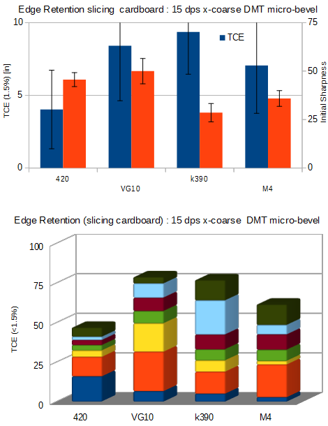

Yes, that was why I made the comment about bias. Here is the latest round of one of the silliest, but yet very informative comparisons I have made :
Now I knew there was cardboard scatter, as I had seen it but this really makes it clear and hopefully shows that even with a lot of attempt to constrain influences (all same edge angles, apex angles, grit finish, length of edge, curvature, etc.) - then just the cardboard alone causes massive sway.
Look at the M4 runs for example, note how two of them are very short. Imagine someone using that knife, getting two of those results back to back and what do you think is the likely conclusion formed? Especially if it was compared to the VG-10 which had those two large runs back to back.
One of the things I do when I become very convinced I am seeing something interesting is give the knife to someone who doesn't know anything about steels (and doesn't really care) and ask them what they see. They can't be biased and if what I am seeing in the data I collect is a real effect then it should show up consistently, if it doesn't then that indicates possible problems with the data collection.
