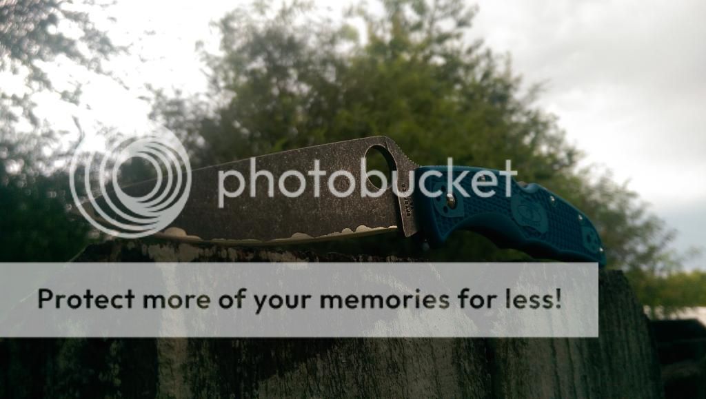

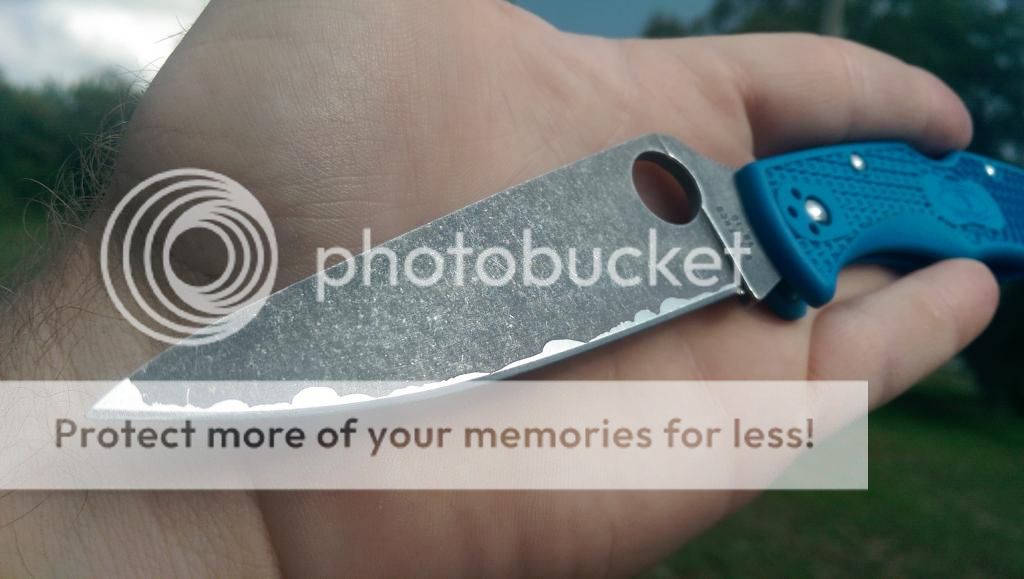

i just did a endura not too long ago. get some nail polish and put it on the pivot to protect that. i also put some on the edge but you dont have to. i used pcb etchant solution from radioshack and it darkened it up nice but cant see the spydie logo anymore. for stone washing i just grabbed a few handfulls of that fishtank gravel and then went in the yard and found a few bigger sized rocks and put them in a tupperware container with some water and dish soap. taped up the lid, wrapped it in a towel and threw it in the drier with no heat for 30 mins. came out pretty good.
oh yeah. i also used the sharpmaker with the medium and fine stones and sharpened it right back up.
