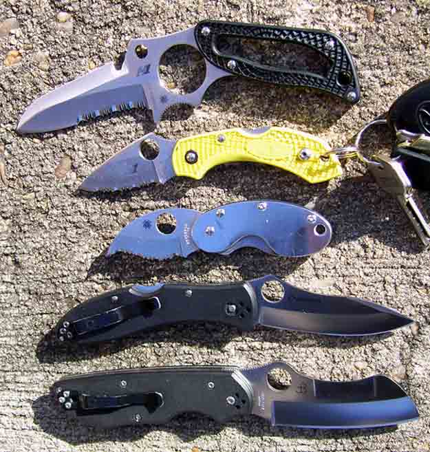

The grinds on the Breeden are some of the best I've ever seen.
My :spyder:'s : Sage 1, Native 4, Cricket, Dragonfly 2, Tenacious, Persistence Blue, Jason Breeden Rescue, Cat, Delica 4 Grey FFG, Renegade, CF Dodo, Orange Endura 4 FFG, Lum Chinese Folder
