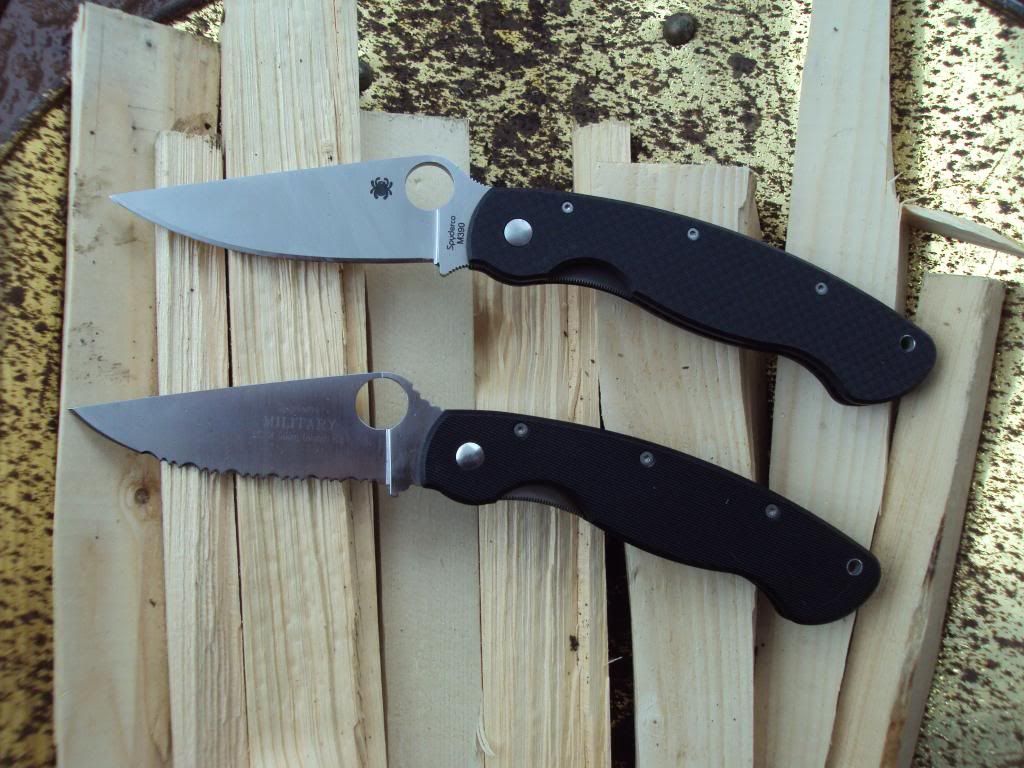

I'll show you what I would do:
Now I did this with a belt sander. You will notice that the tip has a bit of color from one pass that was too slow and it discolored a bit which undoubtedly changed the temper in that section at least. If you send it to Spyderco to have them fix it, you should not have to worry about it being over heated. They will do a rock solid job.
I tried the reverse Tanto point prior to doing the full spine regrind and I just could not get accustomed to the profile personally. I thought my attempt looked more like a D'Allara rescue more than a reverse Tanto. Looking forward to seeing the rejuvenated point. :)
