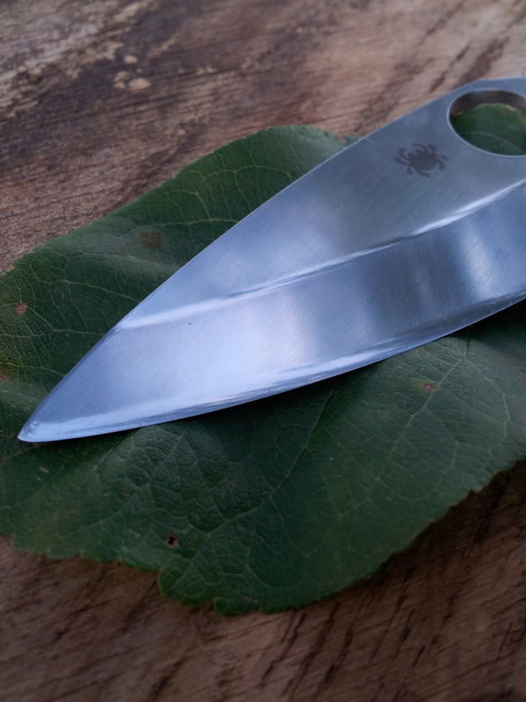

Anyway, back to the topic. This might sound very weird to many of you guys, but after using my manix 2 for awhile, I decided to put a convex edge on it. Now, I really love convex edges on my fixed blades, but I had no idea what a convex edge would do to a folding knife. Also, let's not forget that I have the standard manix with the saber/hollow grind blade. It took around 1 1/2 hours with a 400 grit sand paper. After that, I put on a really nice shiny edge with a 1000, and then 2000 grit sandpaper. After I was finished, I went out and cut a thin branch (around 1 centimeter in diameter). It went right through, without much resistance. It was a much easiee cut than with the V edge. After cutting up a load of brances and twigs, the 154cm was still sharp enough to cleanly slice paper. I was seriously impressed with the performance. I really want to hear everyone's opinions on convexing folders.

Thanks to all for a warm welcome. To answer some questions. I only convexed the edge (the actual v cutting edge), as it would of have taken WAY too long as Pockets said to convex the entire blade and remove the saber grind. I may one day try to grind a full convex edge and see how that cuts :D My camera kinda sucks so hopefully I can take a few descent pictures with the phone.

I know what a convex edge is, but have never attempted one. The edges on your Manix look quite nice to me :) I'll bet the Manix makes for a friendly, tough, and sharp blade :) Also enjoyed the pics of the edge. 154CM shines up really nicely :)

Thanks :) , and yes, you are right about 154cm shining easily. After a fair bit of use, of the knife has dulled and the polish went away, all it takes is 2 minutes on a strop and the shine and edge is back. And yes, the manix is certainly a great blade, and gets ridiculously sharp fairly easily. In my opinion, its a bit of an underrated steel. Glad you liked the pics. :)

Brilliant job. That looks like a fine edge that should last well and be durable. Thank you for the pics!
