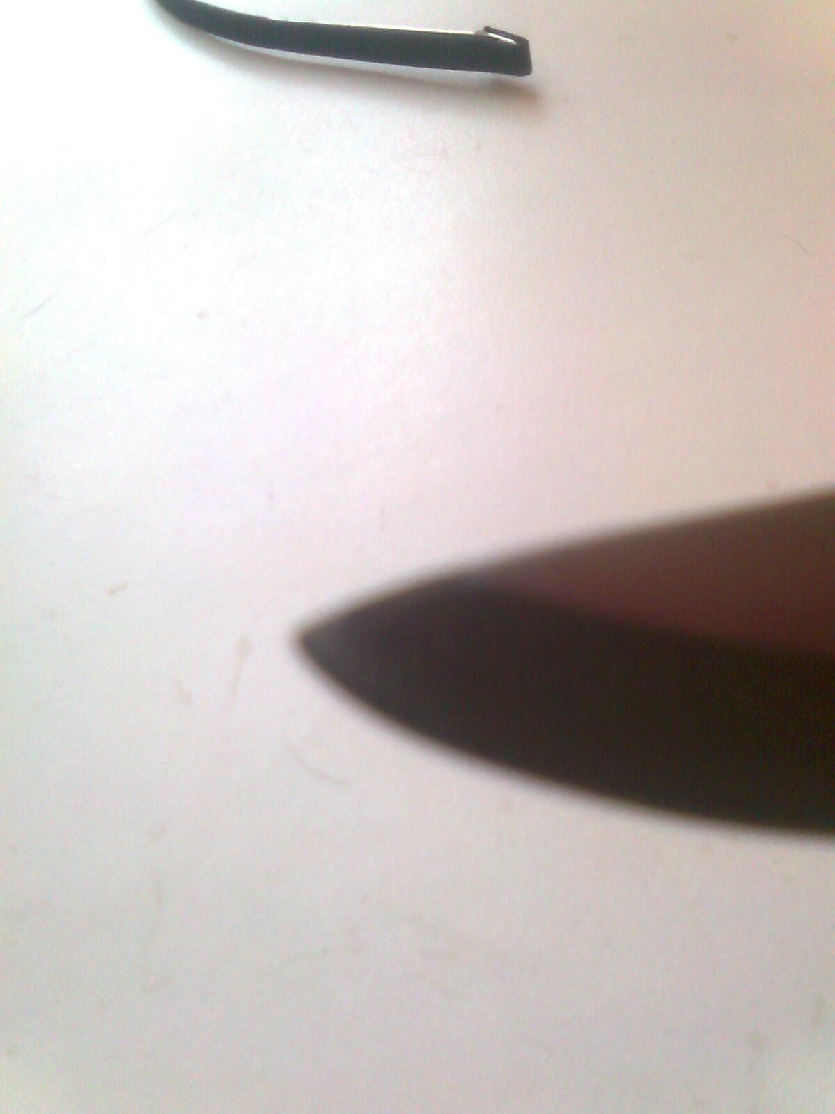

Thanks for replies, heres the picture. Knife is held edge up, pardon the quality-phone camera :) .

From what I can see (even WITH my glasses :) ) it looks like the edge just below the tip needs to be straightened or flattened or how ever you want to say it. Just sharpen that part of the edge. Keep the angle the same as the rest of the edge but I wouldn't really worry about how sharp it is until you get it to the shape you want, then concentrate on the level of sharpenss. The knife looks like it is still in good shape and you should be able to take care of it without sending it to Spyderco. Good luck.

Dang! That pic hurts to look at. :(

Yeah, well, I hope these pictures will be better. JackKnifeh, yup, its like, hmm, excess metal there, too upswept, if its correct to say. Should I file it down with a lansky-stick? I tried a bit now but im not sure if I do it right. Heres how it look.
