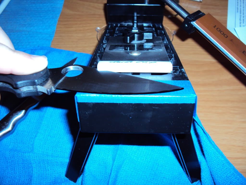

Maybe some of you guys who are more experienced with the edge pro apex can help me out, how do you sharpen knives with a big up swept belly?
For example I'm trying to sharpen my Paramilitary 2, and the following three pictures will show you how I'm holding it on the edge pro's table and I rotate the knife as I follow through with the stroke in order to get all of the blade
starting position
finishing position
Now you can see from this picture, from the sharpie on the edge, that the stone is only getting the entire edge in one spot, it goes from not hitting the edge at all to hitting the entire edge to hitting just the back bevel.
What am I doing wrong? I've got the angle set at 18 degrees (whatever the green mark is)

Have you done some other knives on your EP? As of the moment, I still can't get my mind around your problem. What it looks like to me now is that the bevel near the tip is more obtuse than on the heel. Your angle setting just seems nearest to the actual bevel around the belly.

Why are you moving the blade?
For knives with blades around 5" and under you don't need to move the blade at all.

Is that the factory edge you are trying to sharpen? If so,I would just create a new bevel to match whatever angle you want (18 deg), then the next time you sharpen it, it will be easier since you already have the edge angle established. My D4 ffg was like this when I first had to sharpen it after the factory edge was dulled. I use a Gatco and sharpmaker combo,and it took a full re-bevel to get a consistent edge, but now that I've got a fresh re-bevel (I use 20deg per side) sharpening only takes a few minutes.

I agree to rebevel it to what you want. Then you know what to do for next time. I sharpen all my knives at 15 degrees. Makes it easy and you don't have to remember down the road.:-)

suedeface wrote:Is that the factory edge you are trying to sharpen? If so,I would just create a new bevel to match whatever angle you want (18 deg), then the next time you sharpen it, it will be easier since you already have the edge angle established. My D4 ffg was like this when I first had to sharpen it after the factory edge was dulled. I use a Gatco and sharpmaker combo,and it took a full re-bevel to get a consistent edge, but now that I've got a fresh re-bevel (I use 20deg per side) sharpening only takes a few minutes.
My bet is you are sharpening this knife for the first time. You will need to create a new bevel like suedeface said because the Edge Pro will create the entire edge at the same angle. The angles coming from Spyderco are not the same on both sides or the same along the same side. They are sharpened by hand on a grinder or belt I'm pretty sure. I get that from the video of them making a Native. EVERY Spyderco I've gotten looks just like yours when I start. It's not uncommon for this to be the case and the edge still be razor sharp. Spyderco's knives are normally sharp but the bevels are not consistantly the same angle. During the manufacturing process there just isn't enough time to spend on each edge like we do when we own them. Time is what it takes to get an edge to the condition you are looking for. Like Suedeface said again, once you have the even edge it's only a matter of seconds or very few minutes to keep it that way.
Set the angle to what you want then start sharpening. You will need to pay attention to the areas that the marker is not being removed. It it is removed from the edge but not the top of the bevel that means the angle there is lower than what the EP is set to. If it is removing marker from the top of the bevel then the angle is higher than the EP setting. You need to remove steel from wherever you need to to get the bevel flat from heel to tip. You may want to do this over several sharpenings. As long as the knife is cutting like you want it to that's the main thing.

It's quite common for a factory edge to be more obtuse toward the tip, you just have to reprofile the whole thing first time around.

One you set the edge it will be nice and even.

thanks for the tips guys, I was under the impression that if you matched the Ep stone to the factory angle of the edge, then the EP would hit the entire edge along the entire length.
As for why I was rotating the blade, it's because if i didn't the Ep stone would hit the blade table. I quick back and forth with Ben Dale showed me that I was not putting enough of the blade up on the table of the EP.

The EP is the only "high-end" sharpener I've used. There are others thay may work as well once you get a handle on the characteristics of the tool. Most tools are like that (the good ones anyway). You can set to match the EP to any angle on a knife your friend gives you to sharpen. That is of course if the angles on the edge are already consistant. If they aren't you will be able to make them so. If your friend has never seen a nice even edge on a knife he/she is bound to notice. Keep working with it and in no time you'll be getting results you've only seen in pictures. See Ankerson's picture above. I don't know what he sharpens with but his edges always look good. Too bad they aren't sharp. :) Sorry Ank, just kidding.
