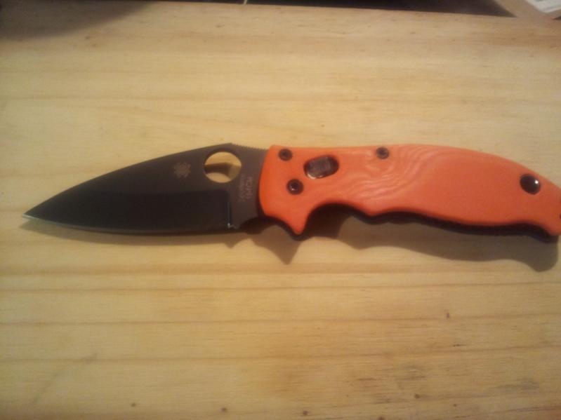

Here are a couple of sets of scales I made if anyone is interested. One scale of each color is on the knife for the "photo shoot". :)
[ATTACH]17023[/ATTACH]
[ATTACH]17024[/ATTACH]
Jack

Looks like they turned out pretty good there Jack, nice job!
