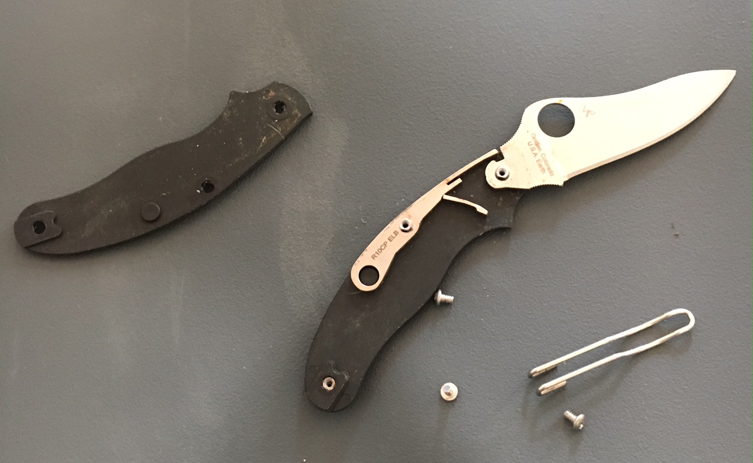

Post by Matt Owen »
It's too expensive for me to "send it in". I live in Spain. (I had the knife imported having heard so much about this particular brand)
However, I have carried out a brief diagnostic and can confirm that the spring mechanism has completely fractured. (See photo). Such a fault to an internal mechanism, I think we can all agree, would be pretty unlikely to happen through misuse.
I also totally understand that they might want to get their hands on this particular item in order to rectify and improve quality , I just don't want to foot the bill for it. I don't think that's being too unreasonable.
Anyhow, I have relayed this information to Spyderco via e-mail and am looking forward to them making it right!
