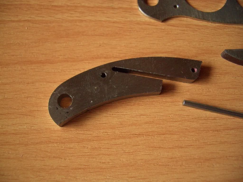

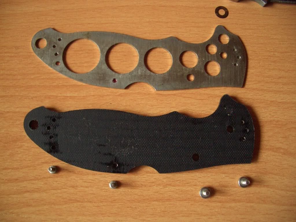

So I took my Manix out of the drawer and decided it could use a good cleaning.... out came my T8 torx wrench :D
....and my camera! It thought some of you might want to take a look into a Manix as much as me ;)
As you can see, it wasn't particularly DIRTY, but it is obvious it was carried.
It was quite easy to take it apart, no surprises here. The screws are not as delicate as in the Military, let alone the chinese made Spydies, virtually no chance to strip them using a proper tool.
After a good cleaning and light buffing of the liners and lockbar, the parts were ready for reassembly. Again, no problems here, it is fairly easy and much more so than with the FRN Enduras and Delicas, since the backspacer is made of metal, doesn't bend or flex and is held in place by 2 screws (no pins). Just reassembe the parts beginning with the backspacer, followed by the lockbar and the spring. After these are in place, insert the pivot and the blade. I took some pics in this stage because this is the most interesting view, especially in the pivot aera ;-)
The knife was easy to adjust to a smooth action, yet next to no blade play. The blade is centered perfectly as before and the Manix is ready to cut again :-)
Thanks for looking!
