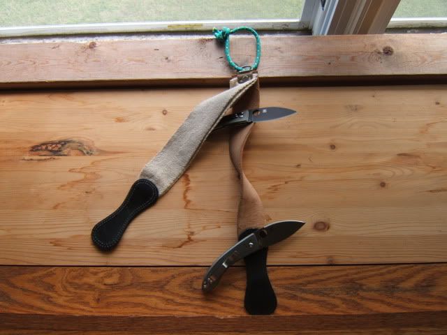

[img][IMG]http://i88.photobucket.com/albums/k198/ ... CF9733.jpg[/img][/IMG]
This is what I use, it is a Zeepk with rawhide on one side and smooth leather on the other. Finishing up with the cotton strop really seems to give it that "pop" I've tried compound but it doesn't seem to make a big difference as far as I can tell. I hook that loop at the top on my big toe and get to stroppin'. Haven't lost a toe yet, and it really puts a poppin' edge on a blade. This one has lasted me 4 years so far and I think I paid about $5 for it on the web, and it seems to have several years left in it.
