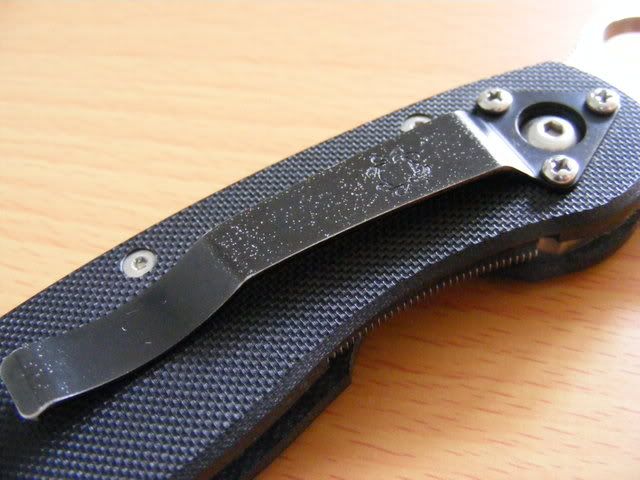

I've noticed that the black clip doesn't hold up to well and it easily scratches and chips off. I just barely had my pacific salt 2 days and already the black is chipping off. How does everybody else's hold up? What do you do to keep it looking good?

this is a commom problem and there's nothing you can do about it. You may want to do a forums search and find that there are plenty posts about this issue. Bottom line: after a few days of EDC, your clip will start to lose the paint; it is worst on the new hourglass clips like on the Enduras, Delicas etc., but the other clips aren't "chipping free" either. That is basically the only serious issue that I have with the Spyderco quality. I just don't like that fact and hope they will solve that problem one day. (Sorry for the rant)
If you want to have a nice clean look again, there's only one way:
strip it! Soaking in Acetone and rubbing it off with scouring pad works, or do it like that.
You can leave it http://i160.photobucket.com/albums/t194 ... 4Clip3.jpg[/img]]like that
or
polish it with metal polish after that, so you get a really nice shiny clip (like on the D4W http://i160.photobucket.com/albums/t194 ... MG7457.jpg[/img]]here). Bad pic, but you get the idea.
It looks nicer without the paint and polished anyway :) ... at least better than with chipped paint :(

Many are resorting to stripping the black coating off of their clips using acetone or some other paint remover. Some even swap out their black clips for polished ones if one is available that will fit. I've heard of people touching up their clips with black permanent markers if there's not much of the paint missing.
One thing I have noticed is that the paint seems to be holding up better on the ti clip of my Salt. Not sure why this is or if I'm just the exception here.

I strip mine.Just beadblasted a Manix and Military clip.
I will say that the paint on the manix clip blasted off fast,the paint on the clip of the camo Military took a good bit of blasting to get the paint off.

I tend to strip mine as well. The one on my Tasman Salt has held up surprisingly well for a couple of weeks of pocket use. I'm going to leave that one alone to see how long it takes for it to start wearing off. On my Police 3/SE, but I stripped that one the other nite - acetone and scouring pad. I have more than few that I haven't stripped and actually don't mind it - gives 'em a bit of "character" :)
