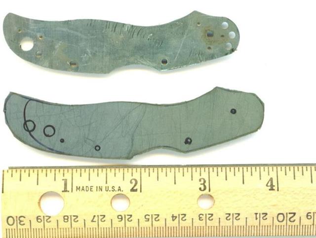

Step 3 and 4 are up.
Seen here is the new spring holder/spacer bar in the correct new thickness and length for the new longer liners and handle. The new folder will have .003 PB washers in it and the thickness of the spacer had to increase by that much or as close as possible to satisfy me. So thats done.
Then my wife helped me prepare for surgery and I went out and cut the G10 scales. Thats up below also.
Next up we drill holes after marking them precisely.

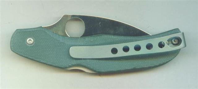

Ok this one is done but I think I screwed it up Friz. I'm afraid I'm going to have to have it a couple years to figure it out too because its that bad.
Not buying it? Yeah me neither. I guess this Kopa has been officially assaulted. :D I named it the "Kopa XL" in the final pics.
Personally I'd carry this one without the clip but I know Friz likes them so I am sure he won't. Anyway, on to other projects.
Thanks for looking.
STR
