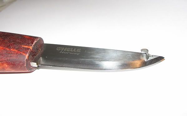

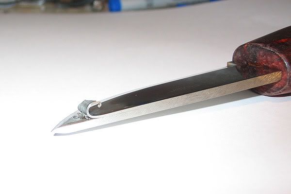

Got to agree with Joe on this one. Laminated knives can and do delaminate under normal use. Admittedly, it's rare, but it causes be to question the wisdom of using a laminated blade in a bushcraft knife, because of the battoning. This one is a Helle and the picture was posted by a bushcrafter on BB (Toddy). I cant remember the exact circumstances she was using the knife, possibly battoning, but she wasnt abusing it (unless you call battoning abuse).
