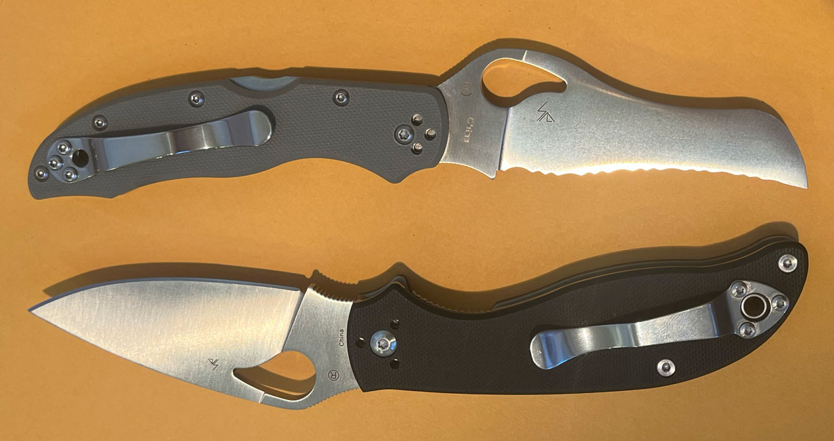

I have a few smaller Byrds, but I’ve only had one Big Byrd before this, a Raven 2. Now I have a second Big Byrd, the Gooney SE. In my opinion, both knives are a little big for me to EDC carry, especially in a nanny state, but your mileage may vary.
As with other Byrds, the Gooney is generally well made, with very good fit and finish. However, this sample has a finish flaw that is ugly, though fortunately, not casually visible. With the blade open, on the underside of the backspacer, there is a bad flaw that was partially smoothed during build. This isn’t pocket jewelry, it has no effect on function, so I don’t really care.
As the handle appears to be the same handle used on the Byrd Harrier model, its comfort in use is already well established. The Gooney has narrow, embedded liners (minimalist, according to Spyderco) that tie the knife pivot to the lockbar pivot and the backspacer. I like backlocks for their sturdy reliability and in-pocket safety. But sometimes new ones can be like this Gooney: very stiff. It can be fully opened by thumb with minor difficulty, but Spydie flick? Not a chance. As a utility knife, all I care about is that it open and close with one hand. My Gooney sample currently cannot be closed one-handed. It’ll improve with use.
The Gooney blade is thin enough (0.11”), when combined with the Spyderedge should make the Gooney a superior cutter (the Raven 2 blade is listed at 0.15”).
The reverse-S shape of the edge lends itself to cutting cardboard, rope, hose, and other every day items. In my only cutting so far (cardboard and one rubber hose), the hooked bill and reverse-S shape of the Gooney edge effortlessly hangs in and keeps cutting, while blades with bellies need extra care in use as they tend to slide or roll out of the cut. I’m looking forward to putting this beast through its paces. As far as the steel goes, I thought 8Cr worked well enough, but it tended to rust more easily than it should have (I have to make certain my Hawkbill is clean AND dry before putting it away after gardening). With 18% chromium content, 9Cr18MoV should be very rust resistant.
The Gooney is different, but as usual with Sal Glesser designs, the style has function. I also really like it. The Gooney blade clearly is well suited for utility purposes and for EDC where carrying a knife of this size is allowed. This one will live in my shop. Some months from now, I’ll post a followup of how useful (or not) it truly is.

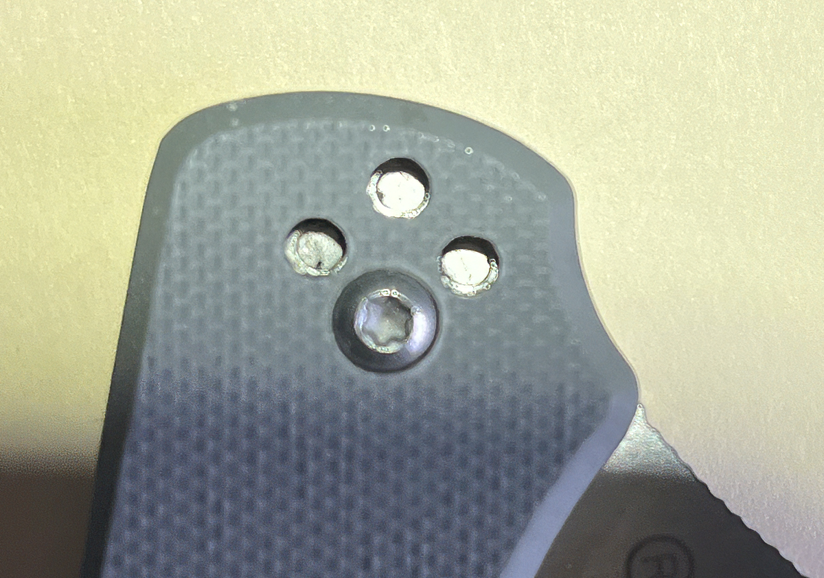

I've come up with an interesting quality control issue with my copy of the Gooney.
Byrd pocket clip screw patterns are pretty standard Spyderco patterns. I often replace Spyderco/Byrd clips that don't work for me with Lynch NW clips.
When I replaced the clip on the Gooney, I found that one original pocket clip screw was covered with a clear-to-slightly white adhesive. When I got the screw out, it turned out the bottom threads on the screw were stripped and likely cross-threaded. Someone "fixed" the stripped screw by glueing it in place.
A close examination revealed that particular screw hole had poor alignment between the screw hole in the G-10 and threaded screw hole in the liner. I'm guessing if more people remove their Gooney pocket clips some will find similar issues. This misalignment is visible in other pocket clip screw holes as well.
Sal, a first suggestion for CQI -- have the Chinese manufacturer revise their setup to insure proper alignment between G-10 and liner pocket clip screw holes.

Here are two pics illustrating the alignment issue and one of the fixes applied by the factory.
First shows the Lil Native (Golden, CO) pocket clip holes. They are barely larger than the threaded inserts into the inside of the G-10. Of course, alignment is near perfect with this type of setup.
Next is a Byrd Crow 2 (China). The pocket clip holes are only slightly larger than the threaded liner holes, they line up well, and I had no problem changing pocket clips.
Last is the new Gooney SE (China). There is significant misalignment between the G-10 holes and the threaded liner holes. The factory dealt with this by drilling the G-10 holes much larger. Unfortunately, in this case, the larger G-10 hole was insufficient to prevent cross-threading by the factory.
Pocket clip hole misalignment has been noted by others, but I paid no attention until I tried to replace the pocket clip. Clearly, if someone was perfectly happy with the factory pocket clip, or they removed it completely, this would not be an issue.
This is truly a very useful knife that feels great in hand and does an excellent job. I look forward to the Gooney that CQI will create.
