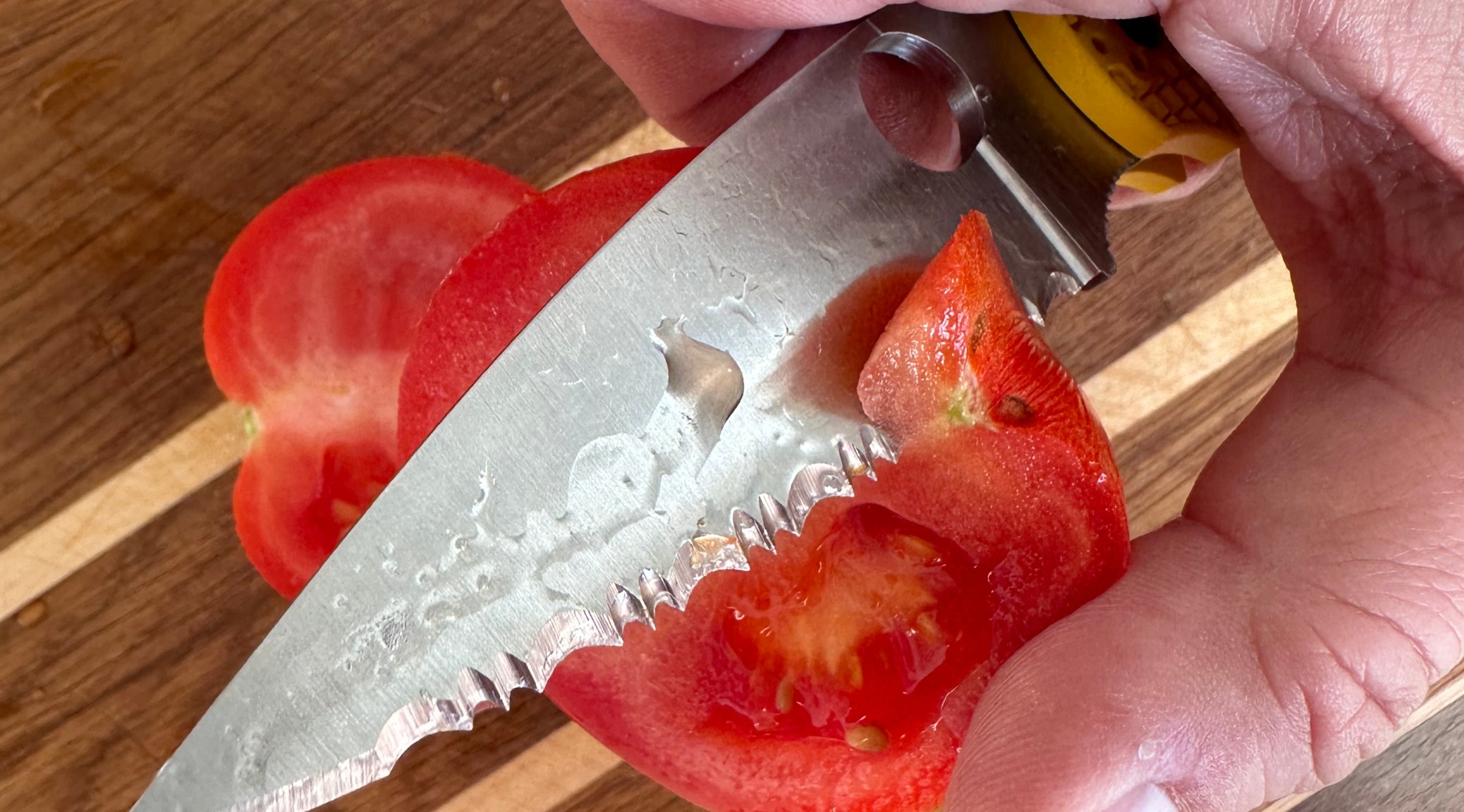

Making Pico? Them maters look good!
JP

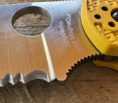

I must say, I am very impressed with S35VN and SE. I gave my bestie this Native 5 Factory 2nd about 3-4 years ago I think. He's a mechanic and he uses his knife for everything that you'd probably cringe over. I've been secretly giving him knives for long term testing for years because he's not at all a knife AFI, not a steel snob whatsoever, and has no opinions on steel type or heat treat or HRC, so he will give you the most unbiased no BS opinion and real world results you could ever ask for.
Because he's hard on edges (and because I fix them for him) I've reprofiled the serrations down to 20 degrees on the front, and I've sharpened it in a full 1:1 ratio of passes left/right on a Sharpmaker just as you'd do with plain edge, so I've intentionally created a small bevel on the back side so the edge itself is a full 40 degrees inclusive. I also just today reprofiled the plain edge section down to 15 degrees on both sides because he likes a standard V edge bevel more than a chisel grind (I have also given him some full chisel grind plain edge knives too).
I took it apart and cleaned it and greased it and it locks up perfectly, no blade play and drops shut. This knife was a 2nd and I think it was because the jimping on the lock bar where it meets the blade is pretty wonky and ground almost diagonal compared to the blade. He has chipped both sections of the edge but it has mostly sharpened out.
He really liked the combo edge, even on such a small blade like this. He uses the plain edge as a scraper and says if the plain edge doesn't cut it "the serrations for d*mn sure will".
I also find it very interesting that even though he's hard on his knife he seemingly knows the limits of what you should be doing with a "plastic" knife and hasn't broke it. I don't think he gets into any situation where he'd have to baton with it and if he needs to do hard prying he has a whole garage full of better tools. But I've seen him use it as a scraper and a probe of sorts and to do light prying like pulling off old brake pads.
Anyway, the lighting tonight was weird but you can see the 40 degree secondary bevel on the plain edge side. I drop down the back bevel just to make it easier to repair edge damage.
I also have no idea what's all over the blade, it won't polish off with Flitz. It doesn't seem like a scratch/scuff either, it's like a streak of chemical stain or something.
BeggarSo
Posts: 1224
Re: SE performance is more than simply teeth vs no teeth.
#1192
Post by BeggarSo »
Break fluid patina.
Even though sneaky you are a good friend👍
Really wanting to buy a 15V Serrated Bodacious. Well a guy can dream, can’t he? :sparkler

BeggarSo wrote:
Thu Apr 16, 2026 5:52 pm
Break fluid patina.
I think it most likely was brake fluid, maybe transmission fluid. I'm not sure which other fluid he might encounter that would be harsh enough to stain a blade like this, and it's not like S35VN is on the low end of stainless.
