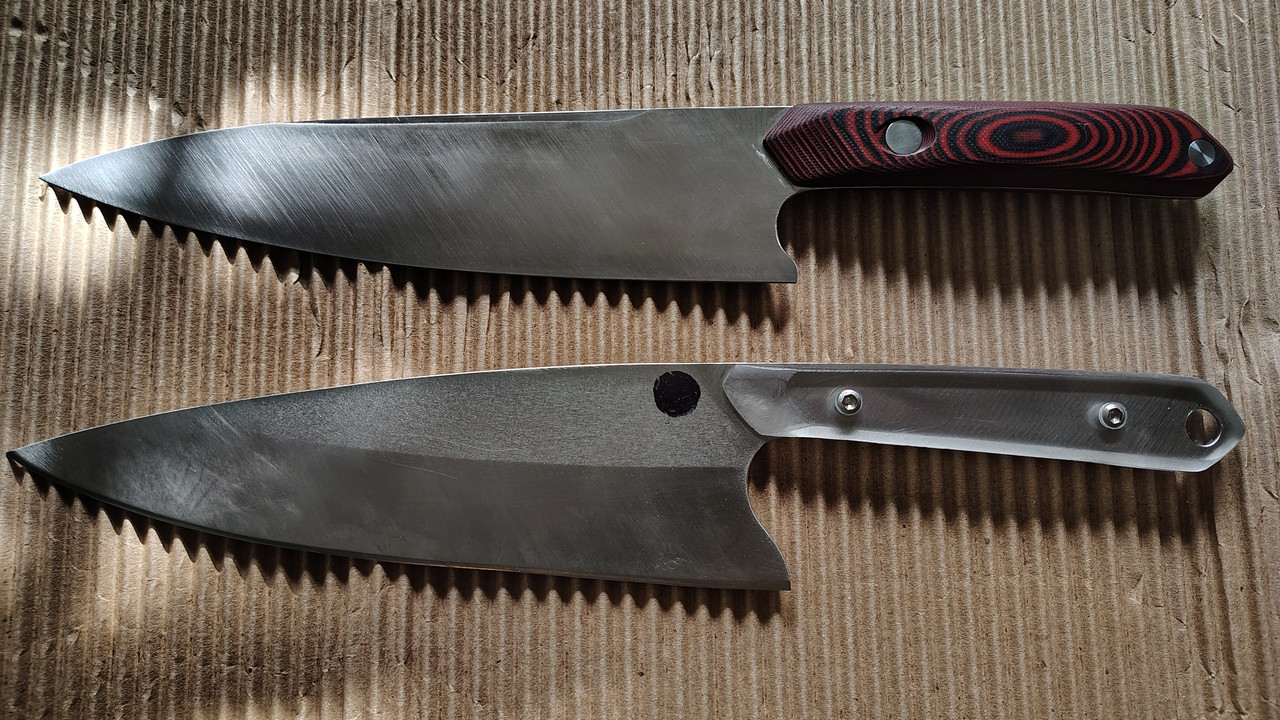

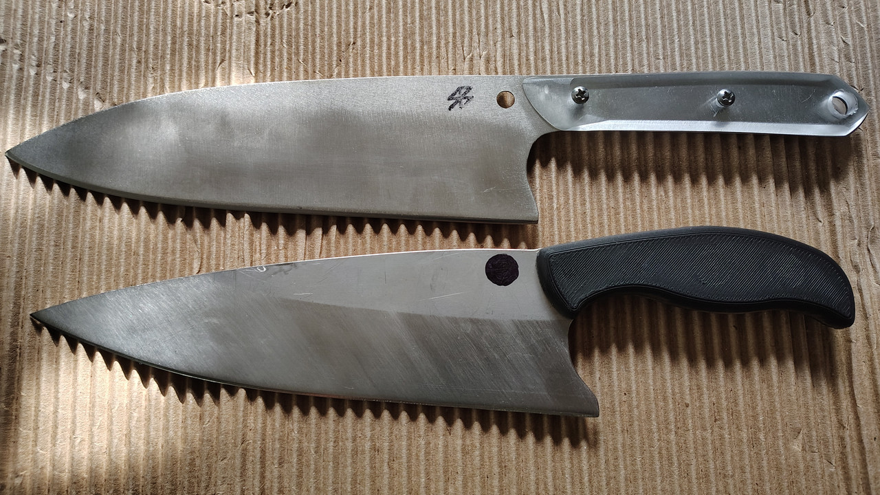

Gonna compare these four to a Victorinox Modern 8" chef knife and Kiwi #21 this week.
Handling the one with a hole I think ya'll are really over thinking that aspect of the design.
I also can tell just from holding them in different grips trying to keep the original mule handle shape won't work as well as a more purpose specific handle, in my opinion.
