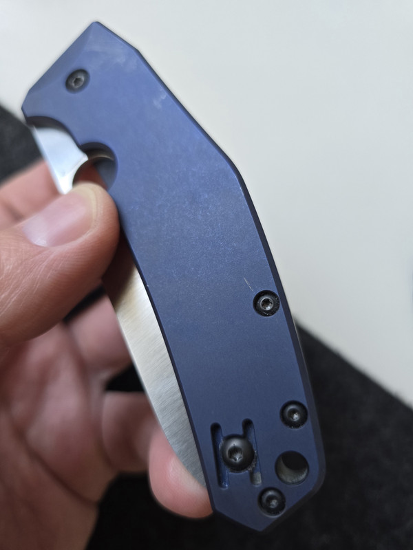

I was getting a little bored with the plain titanium look of my nand so I did a fishscale (blue to yellow/ green) gradient to my NAND. Had previously done something similar to my Ti Demko and was happy with the results. The stonewash texture underneath looks great with the color.
It was pretty easy with a 48vdc power supply at 1A and a baking soda jar. I started fully submerged and started slowly pulling it out as it turned blue. Screws i just heated on my glass cooktop at full power until they were yellow/ tan then i just dunked them in a bowl of water.

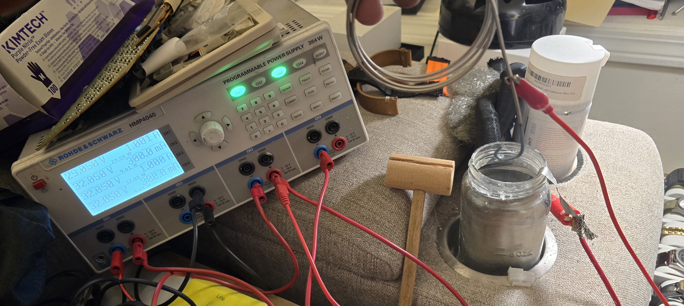

Don't judge the mess too much but here's the setup. Powe supply, some cables. Little bit of titanium wire and an old pasta sauce jar. You dont need a fancy power supply, you could even do it with a bunch of 9v batteries in series. The solution is just a tablespoon of baking soda and distilled water, ive used tap water before and it's fine.
See the charts below for achievable colors. Polished surfaces work best.

Don't worry about messing it up either Beggar, the coating is only a few nanometers thick and a quick beadblast or stonewash will take it off hundred(s) of times before it starts to affect the amount of material being removed to a noticeable amount. Sanding can do it too but I imagine that removes slightly more materialm possibly only donzens of retrys.
One thing I've noticed is that polished or shinier satin takes the color better than a more matte sandlasted finish. Sandblasted comes out a bit more dull/gray in comparison. You can also mask for color patterns like dying, but I haven't done too much of that.
I'll give a higher voltage a try soon with my Spydiechef and share that.
