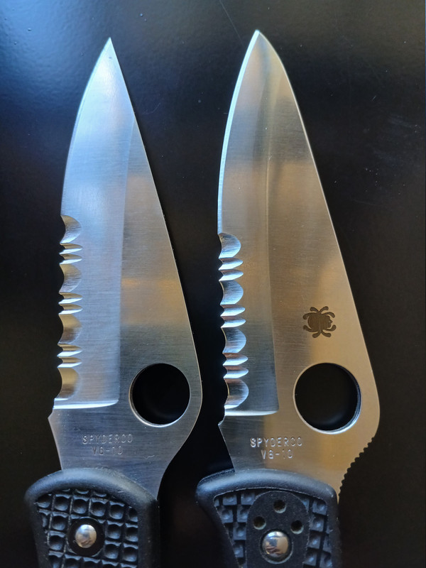

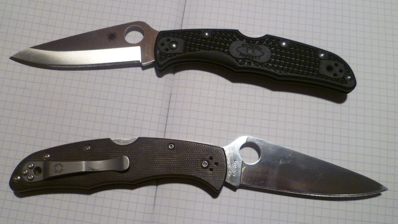

Talked about this quite some times already, but since I came across these old pics let me put it in a dedicated thread:
I pretty much always prefer ffg over sabre grind when it comes to folders, also true for my favorites Endura and Delica.
But there still are arguments for sabre grind and certain scenarios it is better suited for imo.
1.) On a sabre grind Endura the secondary grind / apex goes higher up the blade than on the ffg (given they have the same edge angle) (I think a point that gets overlooked sometimes)
- If a lets say 40 degree incl. edge is grinded into the more obtuse primary grind of a sabre grind Endura, just by geometry it has to go higher up the blade than on the steeper ffg primary grind.
- What does that mean?:
In my experience the sabre grind Endura bites better/deeper into wood, cause the "shoulder" of the apex does not "stop" the cut as soon as with the ffg blade (so the sabre grind works a bit like a "little scandi").
So one can have a very robust edge angle, but still an apex that goes higher up on the blade.
(Pic: Apex Endura ffg vs sg, roughly the same edge angle)
2.) Much more obvious: Very robust blade and especially tip for "super hard work"
- I think the sabre grind versions of Endura and also Delica offer some of the most "hard use" blades in Spydercos line up, despite their comparably not too thick blade stock.
As I always say: Especially the strong and durable tips come in handy when one has to work "hard" AND fast, so it can´t really be avoided that the tip for example hits metal or the like and the blade gets stuck and twisted a lot.
With ffg I´d be much more afraid to snap the tip in that (rare, I know) scenarios.
(Pic: Blade and tip Endura ffg vs sg)
This is a difference in how your specific blade secondary bevels were ground, but if the secondary angle and BTE thicknesses are the same the FFG blade will have a slightly shorter secondary bevel. Which if I’m understanding you is the opposite of what you are hypothesizing.
Anyway, the devil is in the details.
No, I actually did mean and say (perhaps not clear enough...?) that a for example 30 degree apex = secondary angle will be taller ("go higher up the blade") on the more obtuse primary angle of the sabre grind Endura than on the steeper primary grind of the ffg (so, yes, there it will be shorter)
Once more this pic for illustration (apex on ffg vs sabre, roughly same edge angle)

I misread what you had written but that difference you’re showing is 100% due to how thin behind the edge they chose to grind one vs the other.

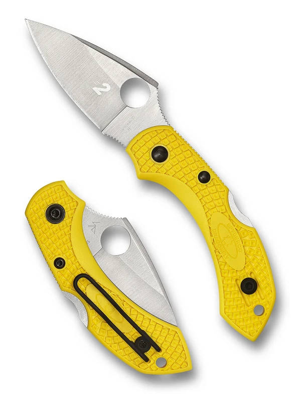

But then: For a general do-it-all EDC knife I prefer Spydercos sabre hollow grind anyway - just like they did it on the old stainless steel handle Enduras (the newer ones "just" offer sabre grind, no hollow anymore).
And going a step further: I think within their sabre-hollow grinds the H2 Dfly blade stands out: I don´t have one myself, but it clearly looks to have a higher sabre grind proportionally seen than the other H2 Salts (for illustration: H2 Dfly vs H2 Salt 2)
Image Image

The Dragonfly Salt has always made me wonder about why the grind height isn't higher on the larger models that (I'm pretty sure) are made in the same factory. It seems like a deliberate choice to grind them lower. If I were stuck carrying smaller knives that would be one of my main choices.

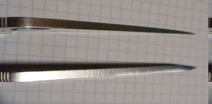

When the Endura 3 / Delica 3 originally switched from hollow saber grind to flat saber grind, at first I wasn't too thrilled. But it turned out that the flat saber grind was high enough that it still sliced pretty well (for me).
When they introduced the E4 / D4, in addition to the tips being thickened, the flat saber grinds were brought lower, making the edges, and the primary grinds, more obtuse.
*I'm in the process of posting a comparison pic here*

When the Endura 3 / Delica 3 originally switched from hollow saber grind to flat saber grind, at first I wasn't too thrilled. But it turned out that the flat saber grind was high enough that it still sliced well (for me).
When they introduced the E4 / D4, in addition to the tips being thickened, the flat saber grinds were brought lower, making the edges, and the primary grinds, more obtuse. As seen in my own two examples below:
I would prefer that the current flat saber grinds on the E4 / D4 be more like they were prior to the 4th generation, but that might negatively affect what makes the current design so popular; the blades' greater durability over the FFG versions.

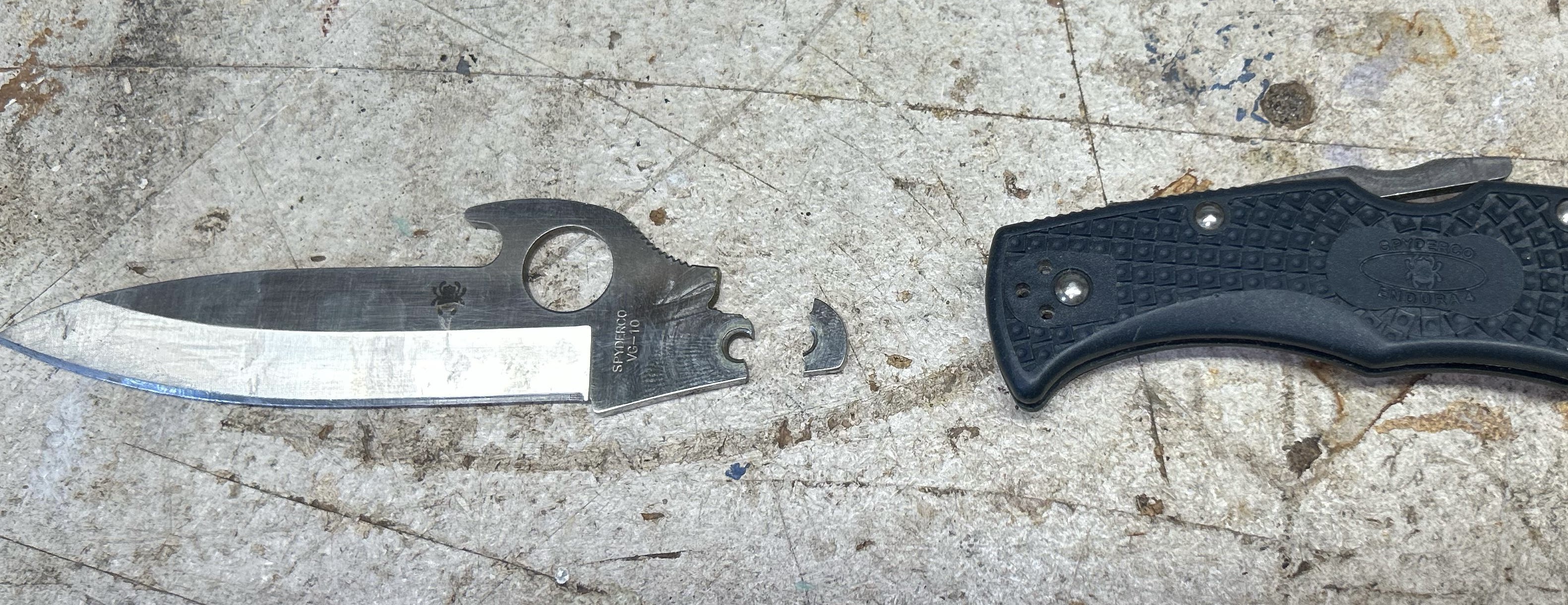

That is a bold claim...
I agree that a robust sabre grind and a stronger tip than a FFG inspires a lot of confidence, but don't overlook the pivot area. It is often the weakest link, and hidden out of sight...
Their pivots are tiny. That is likely true for the whole Endura family. Something to keep in mind before you stress it because of the "obviously very robust blade".
That said, I don't see many reports of broken Endura's. They have proven themselves to be strong enough for normal knife tasks.

Whew... How'd you manage that!
"They say don't speak ill of the dead, I say don't speak ill of the living, they don't care once they're dead."
-- Martha Crowley
Posts: 4277
Re: Endura/Delica: What still speaks for sabre grind (while I generally prefer ffg)
That broken Endura was not mine...
I was quite surprised the first time I saw how small the pivot was on the Endura. For context, compare it to the pivot of another back lock, a Native 5. This one is mine.
I was actually thinking about that before writing my post. I was not sure indeed how "hard use" the overall construction of the Endura is compared to other Spydies and thus deliberately chose the term "hard use blade" (instead of "hard use knife")
But I am fully aware that this is kind of hairsplitting, cause in a lot of situations one could not make full use of the strong blade if other parts of the knife could not take the stress, no doubt
To me personally though how much and how carelessly I can "beat" on a folder for one comes a lot down to tip strength (again, in those "have to work "hard" AND fast scenarios", tip hits metal or the like...)
In that regard imo a sabre grind Endura "beats" most (not all) other Spyderco blades.
Secondly: When actually doing kind of prying tasks (let's say blade buried deeply in hard material and intending to pry that apart) most times and instinctively I kind of pinch grip the strong sg blade, so there is little to no stress on the pivot.
Personally I have never damaged an Endura (actually also true for the ffg ones I have been using a ton and also pretty "hard" sometimes).
But again: I think you are certainly right, and for a perfect folder for all super hard use situations the tough sg Endura blade would most likely have to be implemented into another, even stronger overall construction...
